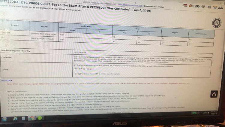

Programming is done via SPS not GDS2. The GR8 or equivalent needs to be connected to the battery while programming. It's about maintaining voltage, not so much charging the battery. Dealers also have a small battery "maintainer" specifically for this purpose. For the record, if a battery is fully charged and in good condition, programming does not need a charger. Problem is that one never knows so it is good practice to use one. Nothing new here. It's been this way for years.

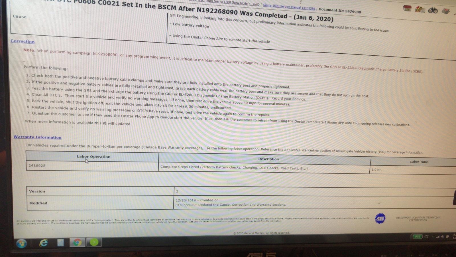

Here is the updated TSB as of 1/6/2020. Sorry for the quality of the photos.
Thanks for posting the updates about the TSB!
