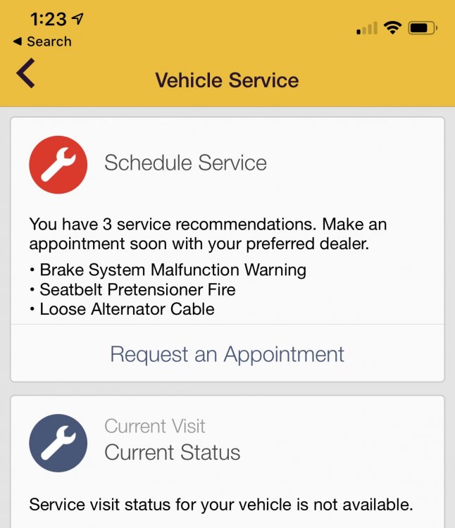

Here is one more I just got

From the description, I get the impression that this will just make sure you get a warning light when you have no brakes, rather than fixing the underlying issue of losing brakes.
I’m actually surprised that these are the first recalls on this truck. My 16 (which was not the first year of a new body style) had one within a week of buying it. This one gave me a 10 month honeymoon period at least, before this deluge of recalls. ?
Have a nice little list of things for them to do next week. Brake % update, defroster vent squeaking like mad on bumps, replacing the plastic trim they broke the last time they worked on it, and now 3 recalls. Better have a damn loaner truck available.

On a side note, lucky me..... I have all three recent recalls open on my truck.  Oh well at least I'm not having any issues as the truck has been perfect so far.  Let GM sort out their problems.
Just had all 3 recalls fixed yesterday along with a brake module swap. Based on the tech, longest part would be swapping the module then completing the recall which is to reprogram it. Other than the 10 hour wait, its painless.
