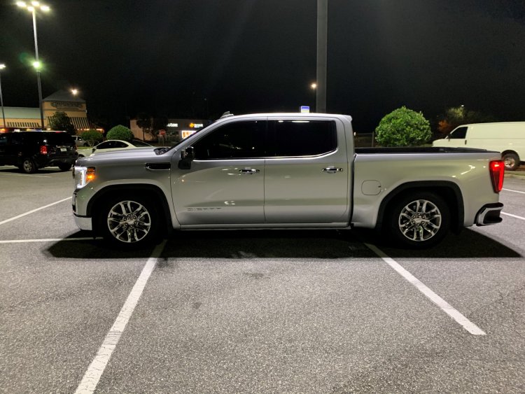

Lowered Sierra
DONS19
WOOOO, i like alot.
Hows you gas mileage?
Did you do a axle flip?
Can you post a few more pics?
What did you buy?
Any vibration?
45 minutes ago, BlancoSilverado said:
WOOOO, i like alot.
What did you buy?
Any vibration?
Have no idea about my gas mileage. Don't really care.
Yes, rear flip, C-notches, cross member notch, and a bed support notch to clear the diff.
I have no more pics as of now
Suspension is Belltech, Wheels are Intro, tires are Toyo. (installing Saurday)
No vibrations at all.

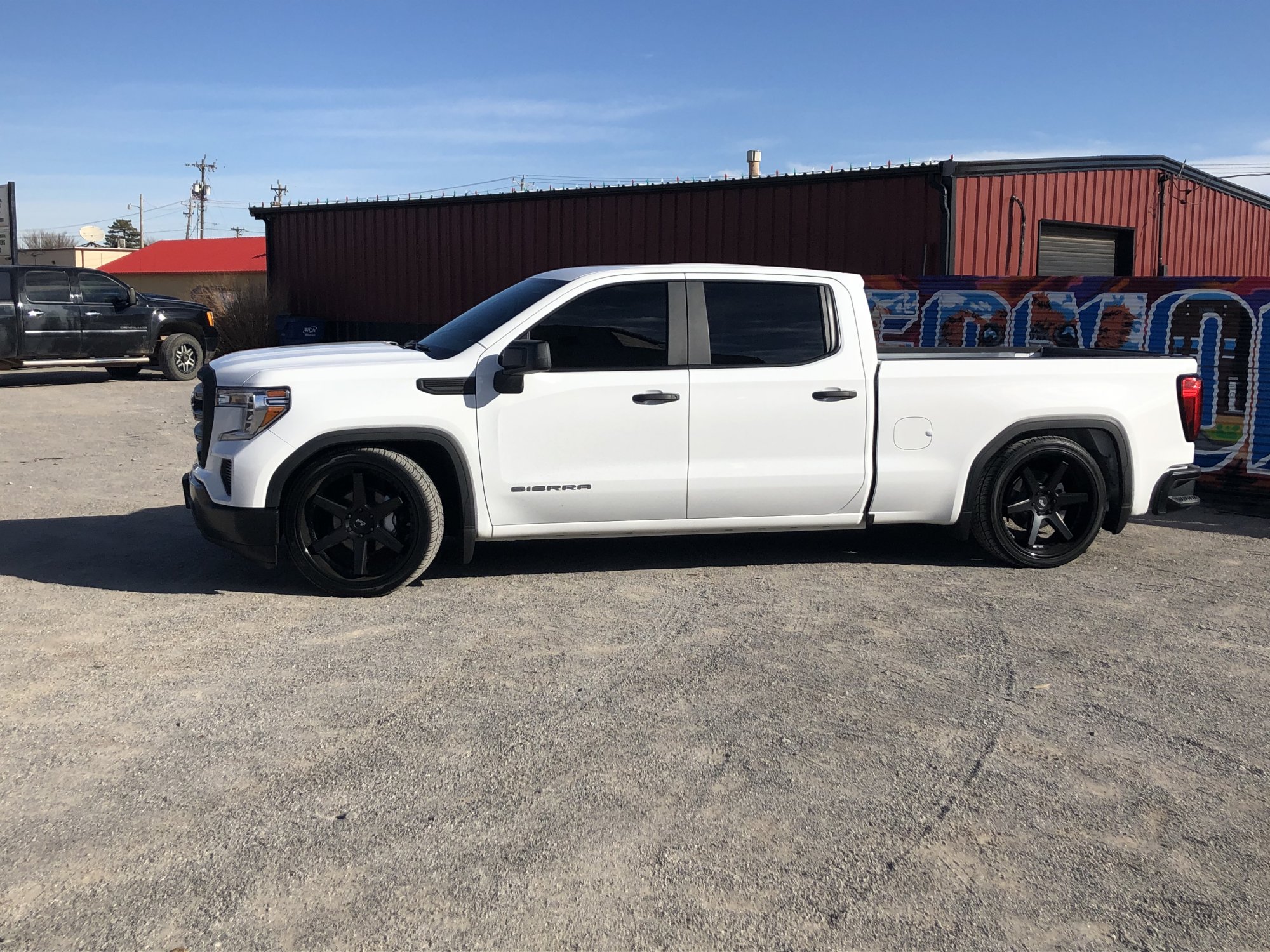

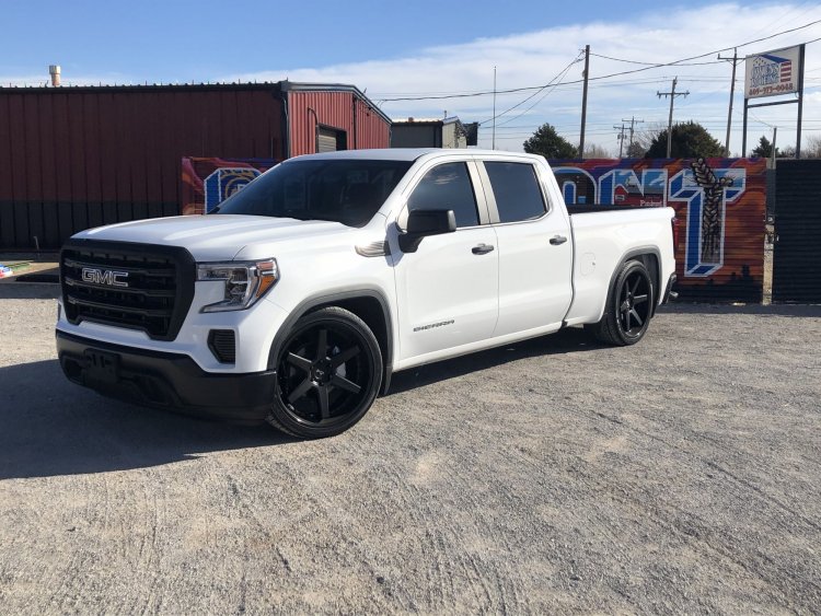

The frames must be way different in the rear than the previous trucks. The GMT-900's and K2XX truck can do flip kits without c-notches all the down to like 7in I thought. Just the bump stop bracket has to cut off the frame.
Looks good going that low.

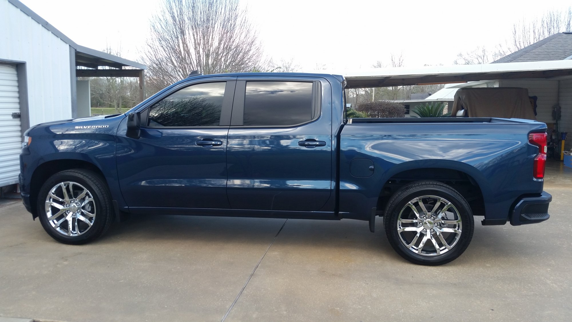

Looks good. I've had several lowered trucks in the 80's. I leveled my '19 with 2" drop shackles and added 22's and Michelins.
NICE! more pix pls. would like to put that kit but cant swallow cutting up my frame.
Looks good! Dealer did the drop and wheels for me. All Belltech street performance.
