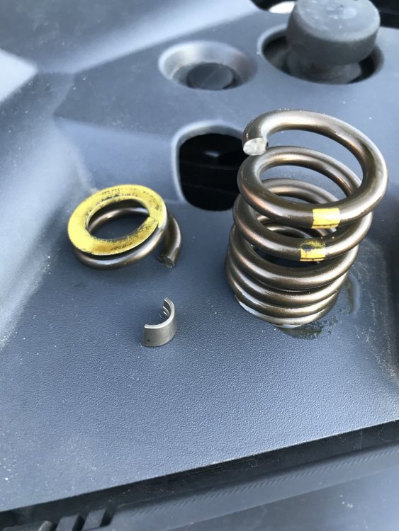

Just for info. Had an afm lifter fail and broke a spring as well as bent a pushrod. Did the afm delete through texas speed. Installed trunion upgrade, tsp stage 2 truck cam. .635 .635 218 226. Pacesetter headers into the one big cat out to a borla xr1 with y pipe into duals. Airraid Modular intake tube with stock box and k&n filter. Ngk plugs and new wires. Truck made 412 hp to wheels at 5200 and 460 lbs torque at 4000. Stock 20 inch rims and tires. Installed and tuned by lsxperts.

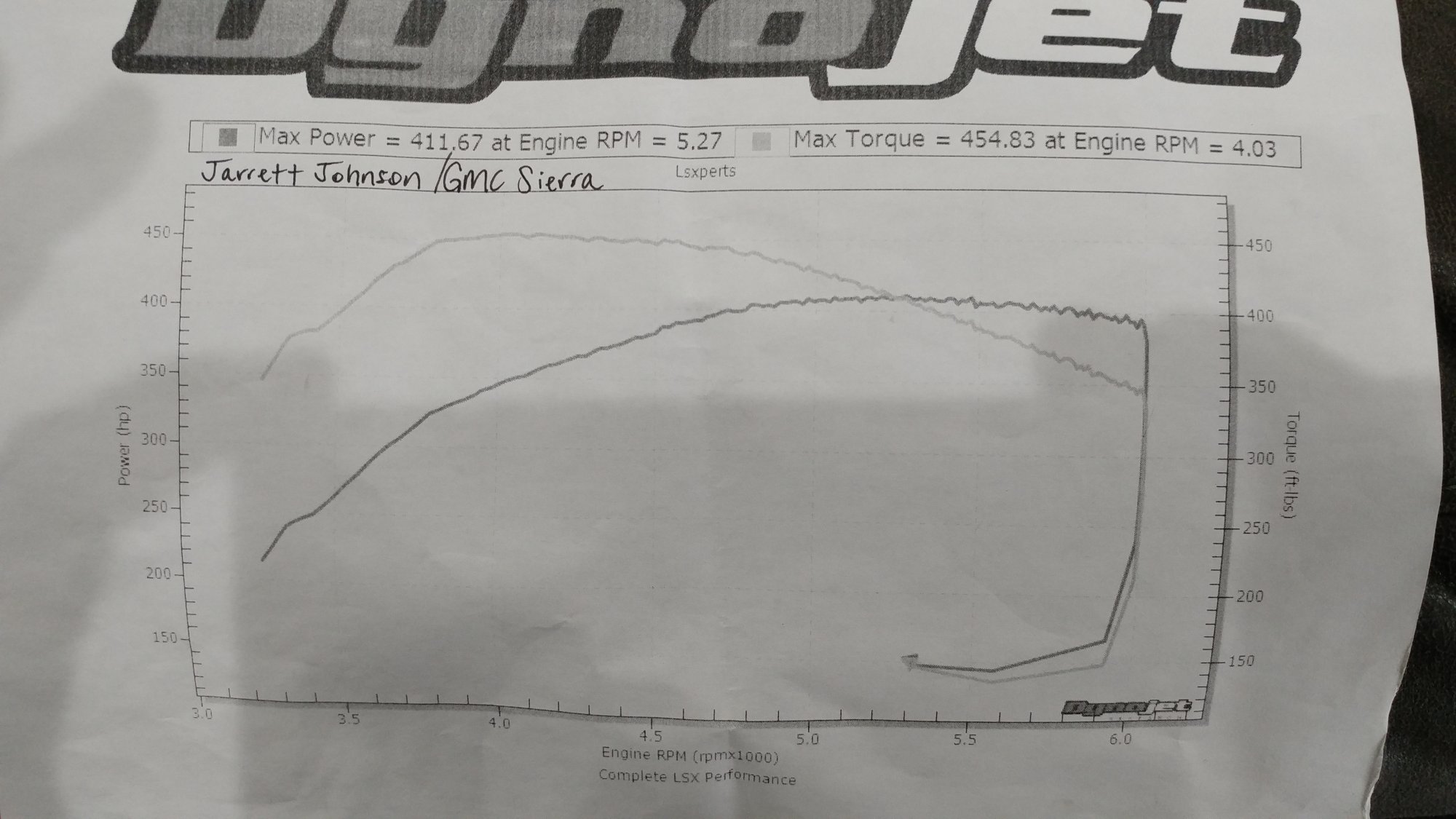

Cool stuff. Exactly what I want to do to mine when my extended warranty is up. I thought I read on the TSP site that your shouldn't go above their SV cam with stock converter but nice to see you have no problems. Do you have a dyno sheet you can post? I'm curious to see the torque curve. Could you also PM me the cost as well if you don't mind? Thanks
This is not the vvt stage 2. Its the stage 2 under 5.3 cams. Its their truck stuff. Its confusing they list l86 cams with lt1 cams. I will post sheet if i can find it. Tons of torque
Ok I understand now. Good deal I was thinking I would only be able to go stage 1 at the max. No wonder why most YouTube vids show folks with Stage 2 cams.
There was still some timing we could pull and make more but since I tow we it was best to leave it
