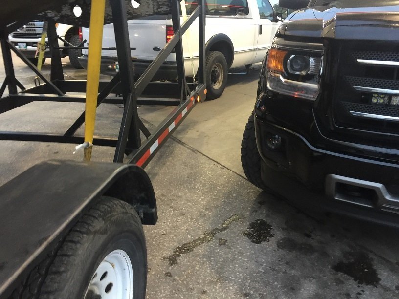

A guy hit my front bumper with a sailboat trailer at the pumps 1.5 years ago and put a small dent in it, GM replaced the whole bumper on his insurance. They didn't want to pay the deductible until I told them I would take the matter into my own hands as I had their client's contact info. They paid the remaining $1,000 pretty quick. Total invoice was right around $2,600 CAD. By the time you pulled the dent and had your bumper refinished you would probably be at that mark anyway. A chrome bumper should be much cheaper to replace as they aren't painted at the dealers body shop. You could put electrical tape over the indicator lights on your dash cam so thieves don't see it illuminated at night. I believe the front 12v plug is always hot, could tap into that.
