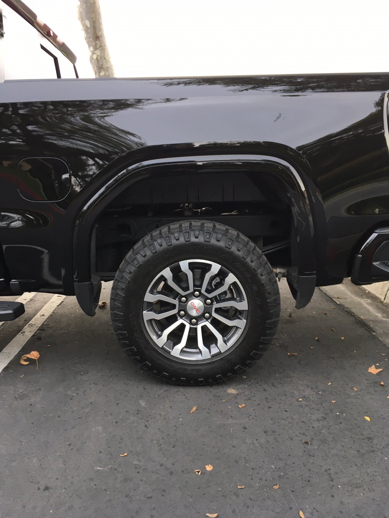

Here is my stock AT4 - 2" from factory - it sits at 38" +/- in front and 40" +/- in the rear - so 2" of rake.  I have a Ready Lift SST leveling kit going on next week - so will post comparision pictures.
