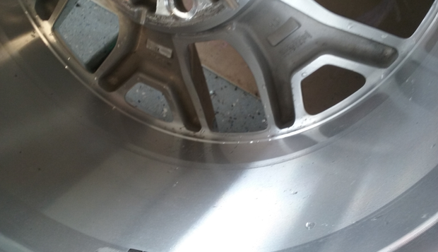

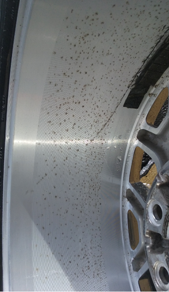

Anyone had any rust/pitting spots on the inside of their wheels?  Was rotating the tires yesterday and three of the 4 looked fine but one had small rust spots all over and wasn't sure why just the one? Just on the inside, the outside facing finish appearance is fine but worrying about it spreading. These are the 20 inch snowflake polished aluminum wheels with 25,000 miles on them.   Is this something that would be covered under warranty? Notice how it's only in the middle and the two 1 inch or so rings around the edge that don't show any rust spots?  Pictures below.  First two are the wheel in question,  Last picture is a different wheel for comparison and they way the other three look, like they should.

Looks like metal from the brake rotor or pads.
It is
It will come right off with some of this.
fantastic, good to hear this should come off.  What's odd is it's just the one wheel, the other three look fine, and the wheels have been rotated every 5k miles so they have spent equal time under different brake/rotors so not sure why just this one wheel is this way?   I'll get some polish and give it a shot..
Did you look to see how much brake pad you have left on the wheel location?  With my 25k miles, they shouldn't be work out, but metal to metal on the brakes makes a mess.of your wheels.  You may have a brake problem the word out 1 pad prematurely.

I haven't looked, mostly because I didn't think at 25k miles I needed to but now I think I will. Don't hear any unusual braking noises or rotor wear but worth a check, something made that happen.
