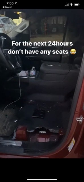

I just started my leather install last night.  Doing a little at the time.  I got the back of the rear seat out and the cloth cover off except on the rear storage doors and the arm rest.  Not sure exactly how they are going to come off yet because all the videos online are with back seats that dont have rear storage or armrest.  Anyone done the install that has the rear storage in the back of the seats and arm rest?
It has been a while since I did mine.  I am pretty sure you have to remove the storage doors to do it.  They have about 3 screws that hold them on.  I looked for a video but dont see one online....
The arm rest has a black plastic piece in the back when you fold it down, behind it are screws that allow you to fully remove the arm rest. There are also screws in the bottom of the cup holder that allows you to remove that plastic piece. From there you can take the cover off. For the behind the seat storage, they come out once you’ve taken the seat off. Behind the seat are screws that allow you to remove the panels.

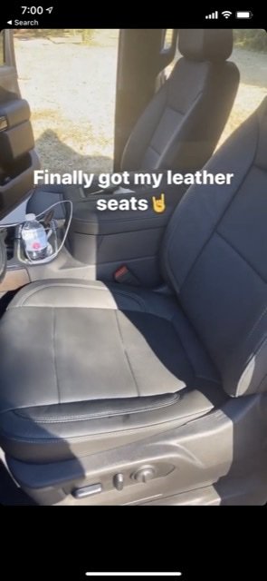

I finished this project.  Wasn't too terrible expect for the front middle seat/console that you had to tear down almost completely to do it.  I did a roadwire kit and you have to cut out holes in the head rest for the buttons and you have to cut holes in the top of the seats for the head rest pins as well as the middle seat/console you had to cut several places on it.  I was nervous I was going to cut somewhere i shouldnt and I think you have to cut on Katzkin kits as well but I think they give you lines for limits of where to cut.
