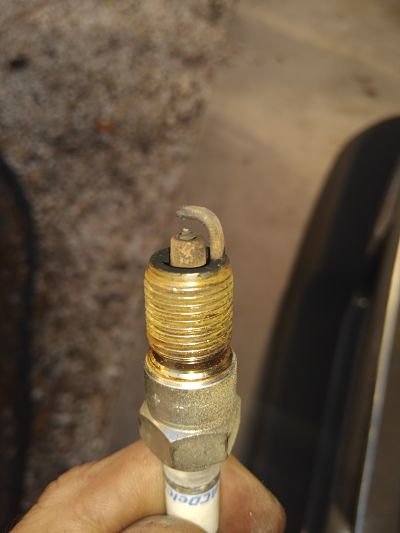

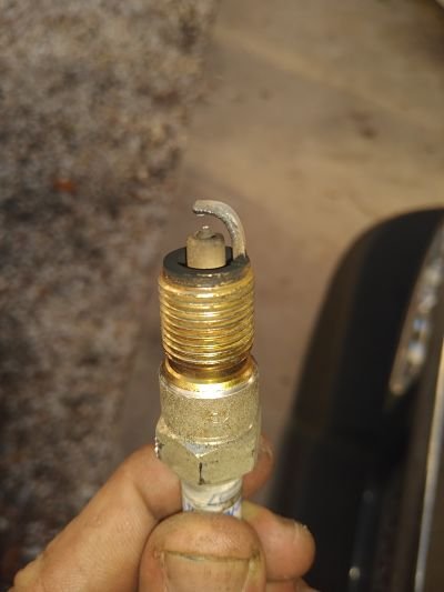

4.8L Spark Plug Analysis (Pictures)

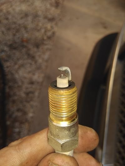

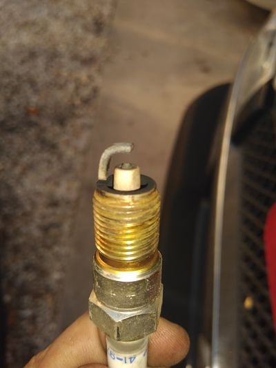

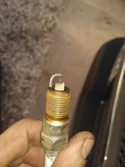

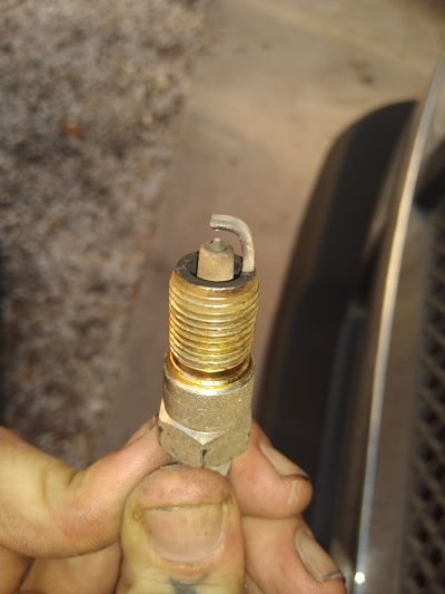

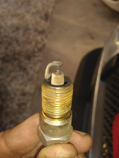

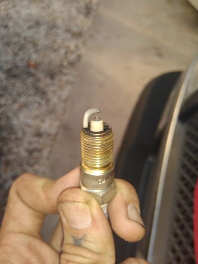

While I'm waiting on delivery man to bring my 3/8" drive torque wrench replacement I decided to take a shot of each plug in hopes of any input from you LS pros. These original iridium plugs were pulled at 150k in my DD, fresh 41-962's going in tomorrow with a new set of ACD wires.
Should have been replaced at 70,000 miles.  Well worn out.

Spark plug reading has never been well understood. Gordon Jennings wrote this article in 1977 for Cycle World and it IS the gold standard for tuning. Maybe Champion still sells the tool for reading them. Even people that should know and don't.
That said you can still learn a lot about the general condition of  your motor by the condition of the plugs over long service like yours.
