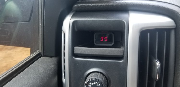

I have the hopkins insight controller. It works great.
https://www.amazon.com/Hopkins-47297-INSIGHT-Simple-Control/dp/B00C5THYIK
I got the plug in adapter for our truck as well so its basically plug and play. I mounted the display in the cubby where the factory control could be above the headlight switch
Mounted the controls in the side pocket of my center console so its hidden but easily accessible. And the brain is behind the panel of the console next to the gas pedal.20190726_112949.thumb.jpg.2f994a53713bbdbb2f22070fdd3a5bcf.jpg20190726_113004.thumb.jpg.20082798a2ae05c2d6f0a1e05cd3a163.jpg

That's really clean I may do this when/if I put breaks on my trailer.
Sent from my SM-J337R4 using Tapatalk
Thanks. It turned out good.
