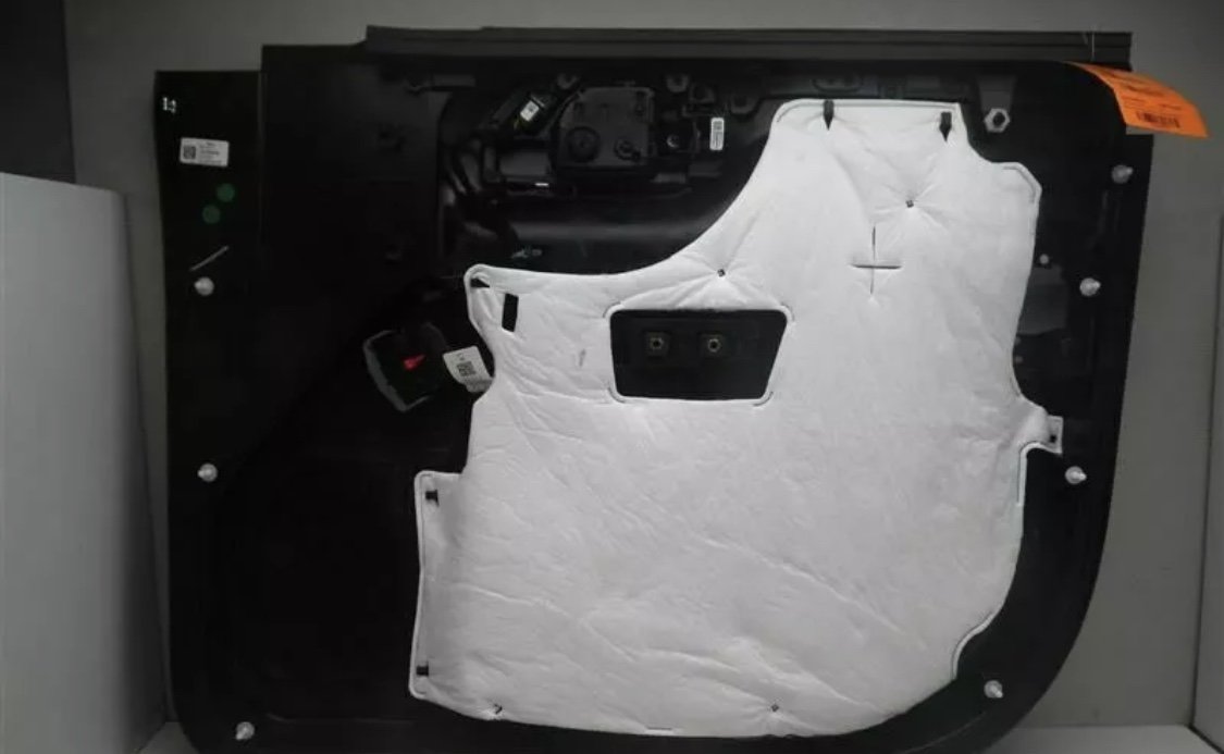

Pulling the panel off, I noticed the door is actually surprisingly well dampened. There are a few side impact bars that run through the door and the door skin is foamed onto the bars. Everything felt really tight and made a solid thud when I tapped it, not tinny sounding.
The main shortcoming I noticed was the vapor barrier. It’s an “acoustic“ type foam, but it was adhered very loosely and is thinly constructed. Tapping the speaker cone induced some rattles because the center of the barrier was not glued to the support bars going across the opening in the door. This would most definitely make some noise and kill some bass.

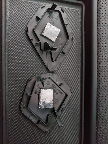

To re-assemble, I snapped the door panel back on carefully. I also applied Tesa tape around all of the clips holding the fake wood trim piece on, as well as a few wraps where it’s tongue slides into the arm rest. All told, took about an hour and a half, just putzing around and engineering things as I went.

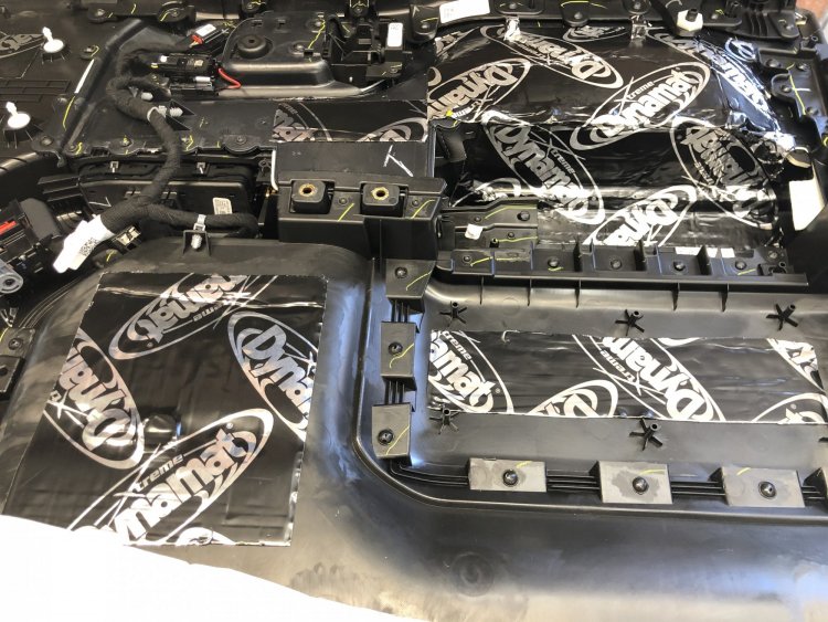

6.       Surprisingly there is actually some factory applied sound deadening. I have highlighted it below. There is a deadening mat that goes across the top section of each of the front doors applied from factory. Who would have guessed.
Install Pics
I applied a bunch deadening behind the white material below. Didn't remove it, just lifted and applied.
