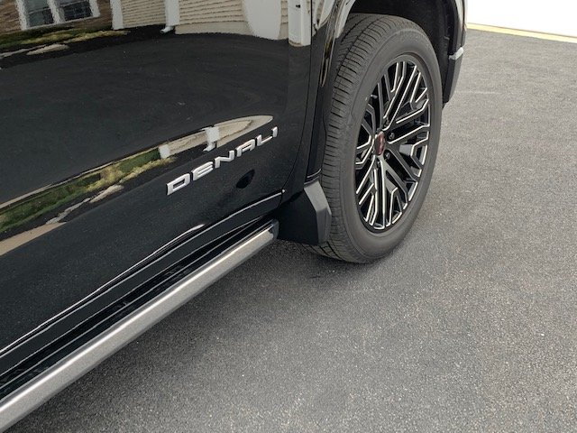

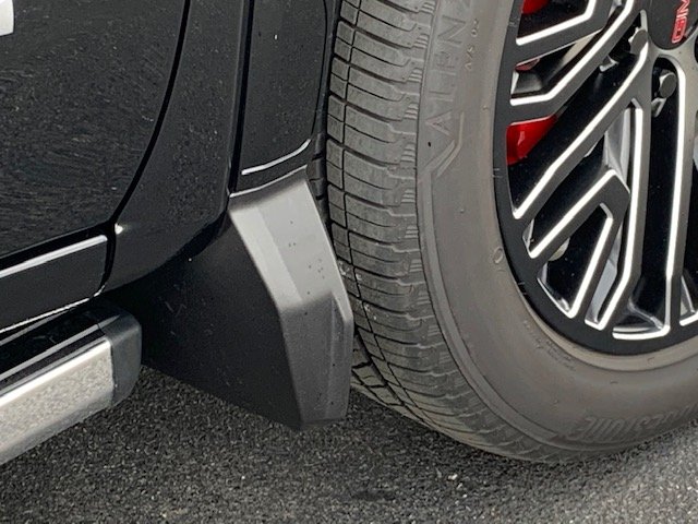

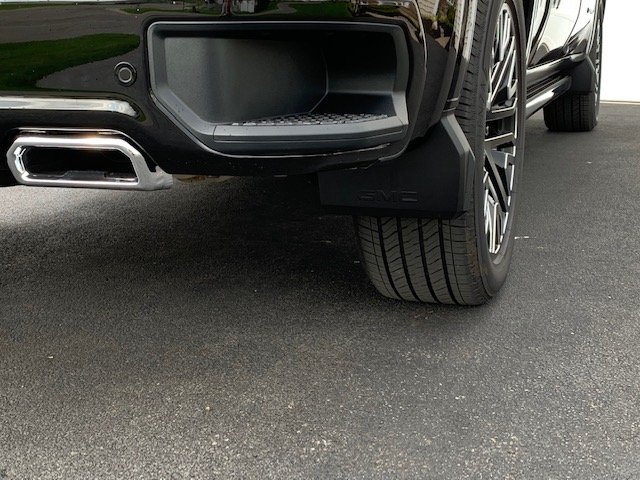

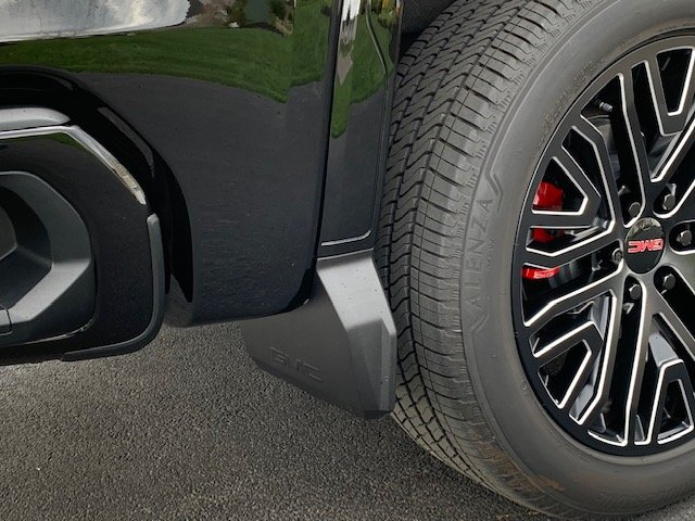

Mine came with the larger mud flaps installed. I'll see how they do with the new wheels I'm getting tomorrow. I might look to switch up to the factory smaller ones. Although, I do agree, these look like they do protect the sides of the truck20200430_140117.thumb.jpg.a1c72918b2e45177163c27ae0be92b9b.jpg better.
Same here, also installed from factory.  As mentioned above they are pretty stiff but I don't mind as they don't move around when loaded up full of snow and slush, and they seem to offer a good amount of protection without being an eye soar.

Thanks! Are they lower then the stock ones too, or just wider?
It has been awhile, but I believe that they are a little lower.
