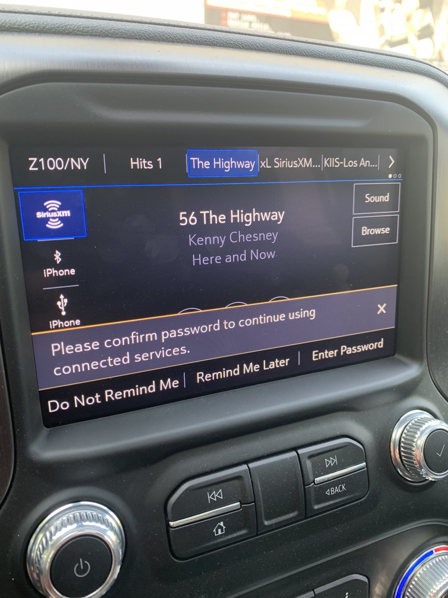

Same here. I tried every password I can think of. Wont go away.
What worked for me was logging into the myGMC/mychevy website first as I needed to change my password there. After doing that, my truck took the newly changed password and I haven’t had this screen pop up since.
What superduper said. You can not do it from the app. You have to go into the actual website and change your password to make it work.

Same issue with my 2020 Sierra SLT X31.  The message keeps coming on  even when I push the do not remind me. Showed the message at the dealership when it happened and was told to read the owner's manual.
