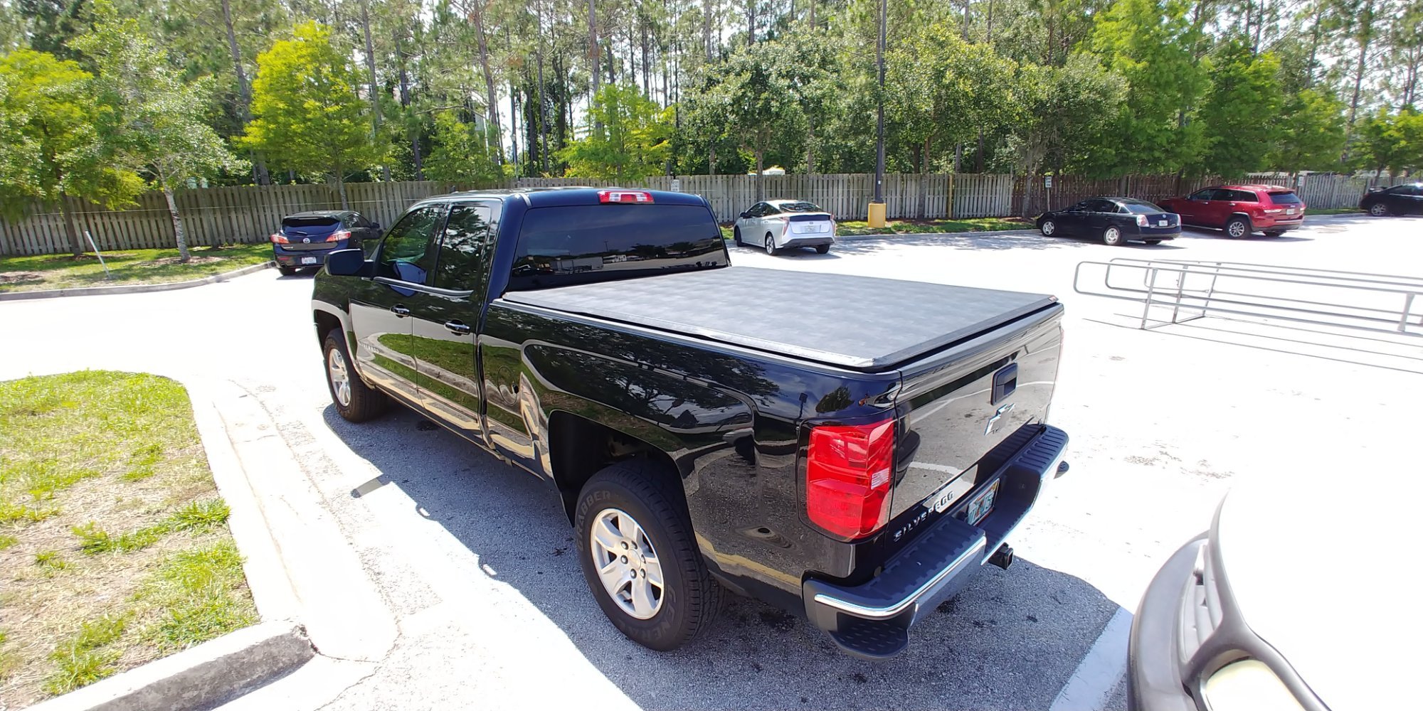

The soft extang trifecta 2.0 trifold is right up your alley. Since it covers up more surface area of the bedrails, tailgate. All it'll need is a 10 dollar strip of weatherstripping at the front part of the bed to complete the seal. I had one on my 17 silverado and I loved it. The soft ones can just be opened with a razor blade so they aren't as secure as the hard ones but it did the job.20180608_150536.thumb.jpg.eda42d476df34093fc56a061c5d2fe41.jpg

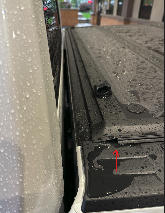

Had our second small rain event today and this thing still leaks at the front corners. It also appears like the front seal allows water through seal channel in which it sits in along the entire width of the seal. Also looks like the drain assembly is no fully sealed with the side rails. It leaks at the joint.20220606_150224.thumb.jpg.33964e153b3a28a282aca405b60a2cd7.jpg

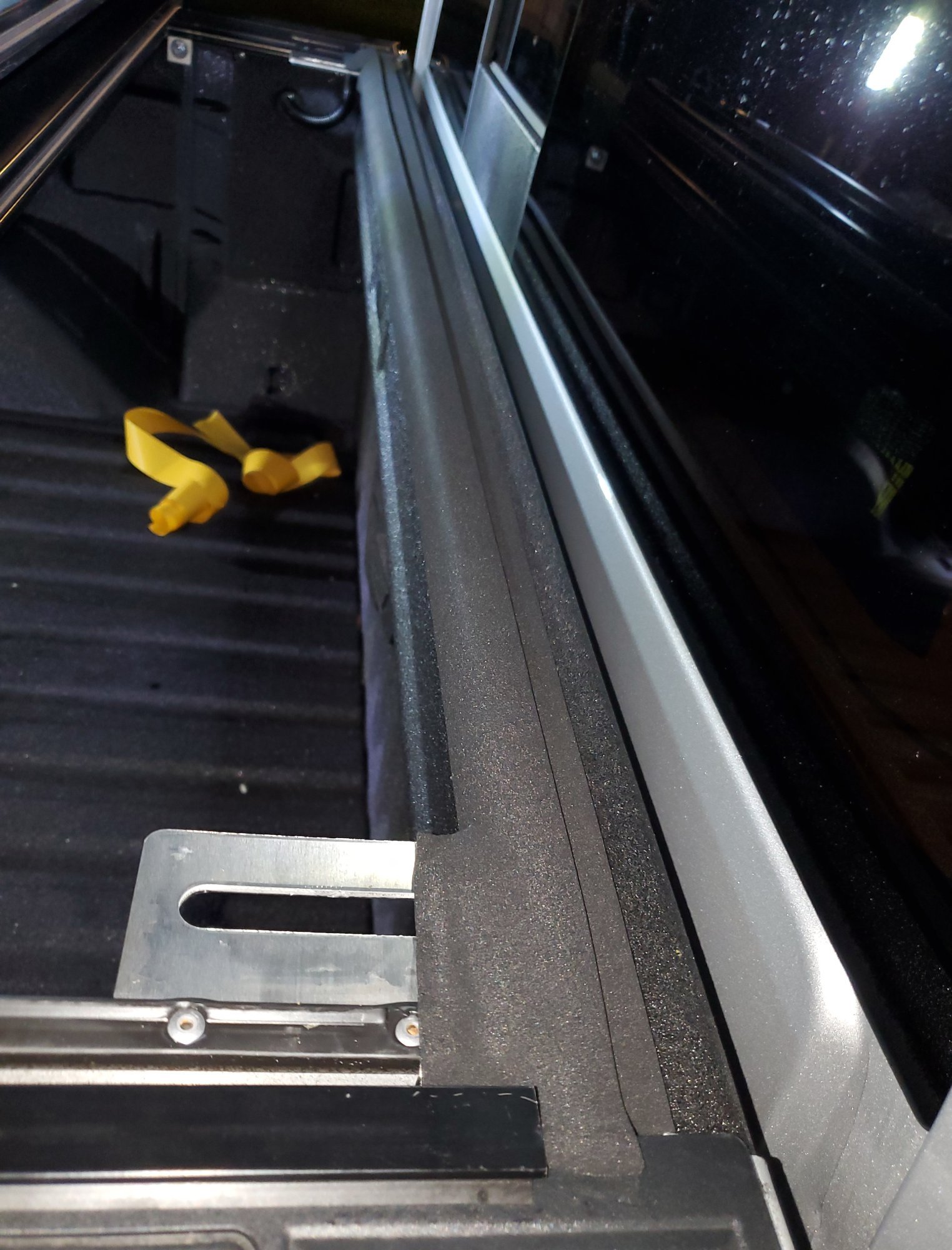

3. at the cab side, there is maybe a 1/16" to 1/8" opening on each side (see photo below).  you can see daylight when inside the bed and it is light outside.  It does look like the rail is all the way up against the bulkhead.  Maybe I need to put a little foam in those two spots too.
Did you install the drain tubes through the side wall or through the bulk head tie downs?  If through he side wall, did you trim the tubes so just enough goes through the hole?  Is there any issue with water going into this cavity that looks like otherwise it would not see water?
Here is a photo close to the bulkhead.  Water can get into that spot.  It feels like the rail is all the way again the bulkhead but probably need to take the cover off to confirm.
