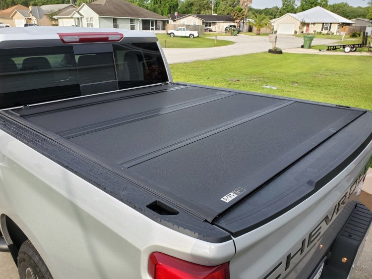

So overall, I am pretty happy with it initially. See below for comments on the seals and weak spots

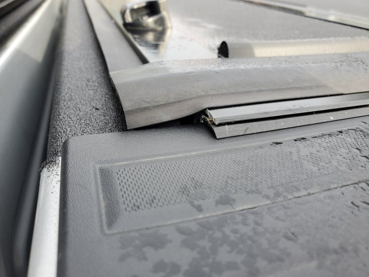

I do with the cover had a little more overall length to cover more of the tailgate and more of the front bed rail. I have the cover adjusted as far back as I can without compromising the weather seal at the front. This seal at the tailgate corners obviously is going to let in water, but I think all low profile covers are going to function the same, just the nature of their design. However, on my last truck, I bought a truck tailgate seal for between the bottom of the tailgate and the bed. There was enough left over material that I was able to put an angled piece in the upper tailgate area just below the gap between the tailgate and side rail basically sheading water towards the rear and out of the bed. I think I will do the same for this cover.

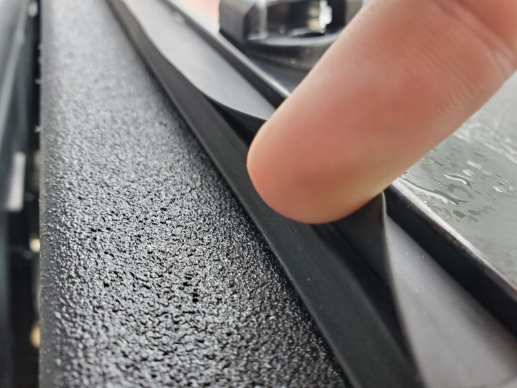

In regards to the font seals, this is a little better than the rear but not perfect. But I should be able to take care of this either with the left over weatherstripping in the kit or a thinner material from lowes or home depot. Having the spray in bedliner does worry me slightly about proper adhearance of the front seal but i think itll be fine as the tonneaus front seal sandwiches it in place.
Another critique I read previously in the thread was in regards to the draining of water from the tonneau rails towards the rear and not the front drain pipe. Obviously gravity is going to determine where the water flows. The trucks OEM stance with the forward rake is why they put the drains in the front. If you have a leveling kit or park on uneven ground, it may influence water that makes it into the tonneau rails towards the rear, where it will just flow into the rear of the bed. I may attempt to mitigate this potential with some type of endcap at the rear of the tonneau rail.
Overall, I know this is going to let some water in, but its just the nature of these low profile designs. Tonneaus that cover the entire bed rail, front rail and tailgate are going to be much better in regards to water diversion, but I like the look and functionality of this cover, especially being able to flip forward against the cab. Hopefully this will help others make their decisions.
