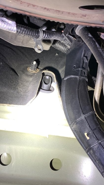

The drain exit is on top of the trans towards the passenger side,
I had the same problem. i ended using ozium for the mold and pushing some air though the exit hole (multiple times).

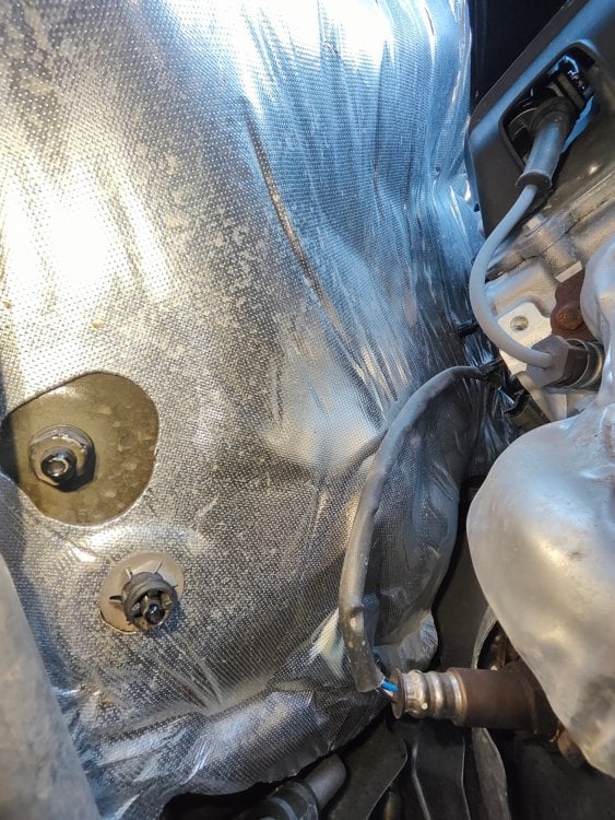

Any way to prevent this from happening? Anyone have a pic of where to snake from if it does clog?
