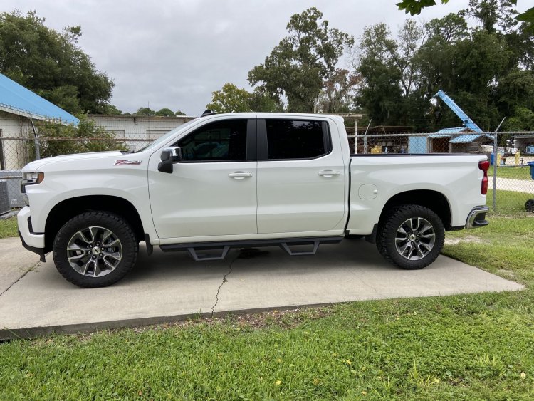

Interested to see if anyone has uses a 3" Front 2" rear level kit on a 2020 Sierra?
Loved this look on my 2016 Silverado, but the local mechanic doesn't reccomend a 3" front on the 2019/2020 MY.

I installed a 1" block on my 2020 1500 LT myself and wasnt hard at all. I have the 2" RC in the front and considering the  2.5" motofab because im right at 1/2" difference between front and back.
Do you have picture of your setup?
not the best angle but I can take another pic later because im in my work vehicle.
