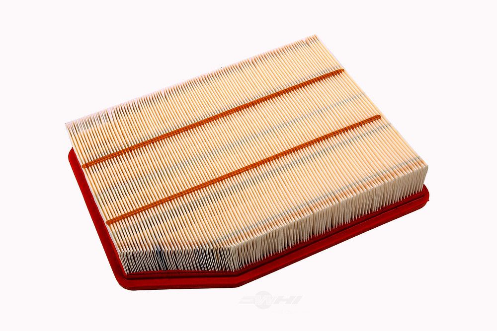

PackerChev Posted August 5, 2020 Posted August 5, 2020 My engine air filter in my 2019 Sierra AT4 6.2L has an extra filter on the bottom. My replacement filter does not. Has anyone ever seen this. Is it because it’s an AT4? Do I need to get the same filter? Thanks Sent from my iPhone using Tapatalk 1
Z45 Posted August 5, 2020 Posted August 5, 2020 (edited) You bought the wrong filter. That's the standard filter Air Filter Part Number: A3244C Product Notes: Air Filter All; HIGH CAPACITY AIR CLEANER(K47); VIN: L, Eng Code: L87, 4 Door, Crew Cab Pickup*; VIN: L, Eng Code: L87, 4 Door, Extended Cab Pickup* Per Vehicle: 1; Years: 2019-2020 Air Filter Part Number: A3246C Product Notes: Air Filter All; Exc HIGH CAPACITY AIR CLEANER(K47); VIN: L, Eng Code: L87, 4 Door, Crew Cab Pickup*; VIN: L, Eng Code: L87, 4 Door, Extended Cab Pickup* Per Vehicle: 1; Years: 2019-2020 Edited August 5, 2020 by elcamino
PackerChev Posted August 5, 2020 Author Posted August 5, 2020 Is there a performance difference?Sent from my iPhone using Tapatalk
CamGTP Posted August 5, 2020 Posted August 5, 2020 It's not really the wrong filter if it fits in the air box. They just make different grades and for vehicle packages. You won't notice a lick of difference between the two filters. I wouldn't even care personally, it filters air and that's all you need it to do. 1
Z45 Posted August 5, 2020 Posted August 5, 2020 K47 Air filter, high-capacity 1 - Included with (BAQ) Enhanced Capability Package, (X31) X31 Off-Road Package or (VYU) Snow Plow Prep Package. 2 - Requires 4WD models. Included with (X31) X31 Off-Road Package or (VYU) Snow Plow Prep Package. 3 - Included and only available with (X31) X31 Off-Road Package. 4 - Included and only available with (X31) X31 Off-Road Package or (VYU) Snow Plow Prep Package.
Z45 Posted August 5, 2020 Posted August 5, 2020 7 hours ago, PackerChev said: Is there a performance difference? Sent from my iPhone using Tapatalk If you buy into the less air filter (performance filters e.g. K&N) = more performance, then about +100hp and +10mpg increase. LOL 2 3
redwngr Posted August 7, 2020 Posted August 7, 2020 Extra capacity, as in holds more dirt and debris, not as in higher airflow. At least not more airflow when new. Maybe more flow remaining when they have collected 'xyz' ounces of dirt/debris. 2
