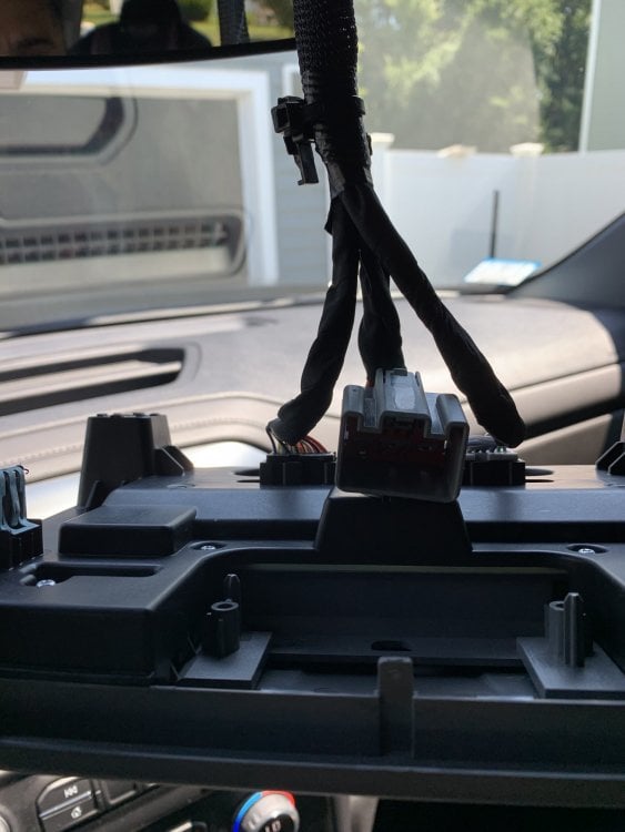

I also have the non homelink console...I took the console down there's a big plug up there with nothing going into it in my LT which I'm 99% certain that's for the homelink plug in... Also up there is the plug for the dimming mirror... That's a plug and play if you're also interested in doing that too..Here's the homelink plug in I believe ...I was hoping that plug also had the power slider figured into it as well???Anyone chime in on what this gray plug enables???
Thanks for the great picture, that helped a lot.  I agree with you about that being the Homelink plug and thanks for the heads up about the dimming mirror plug.
