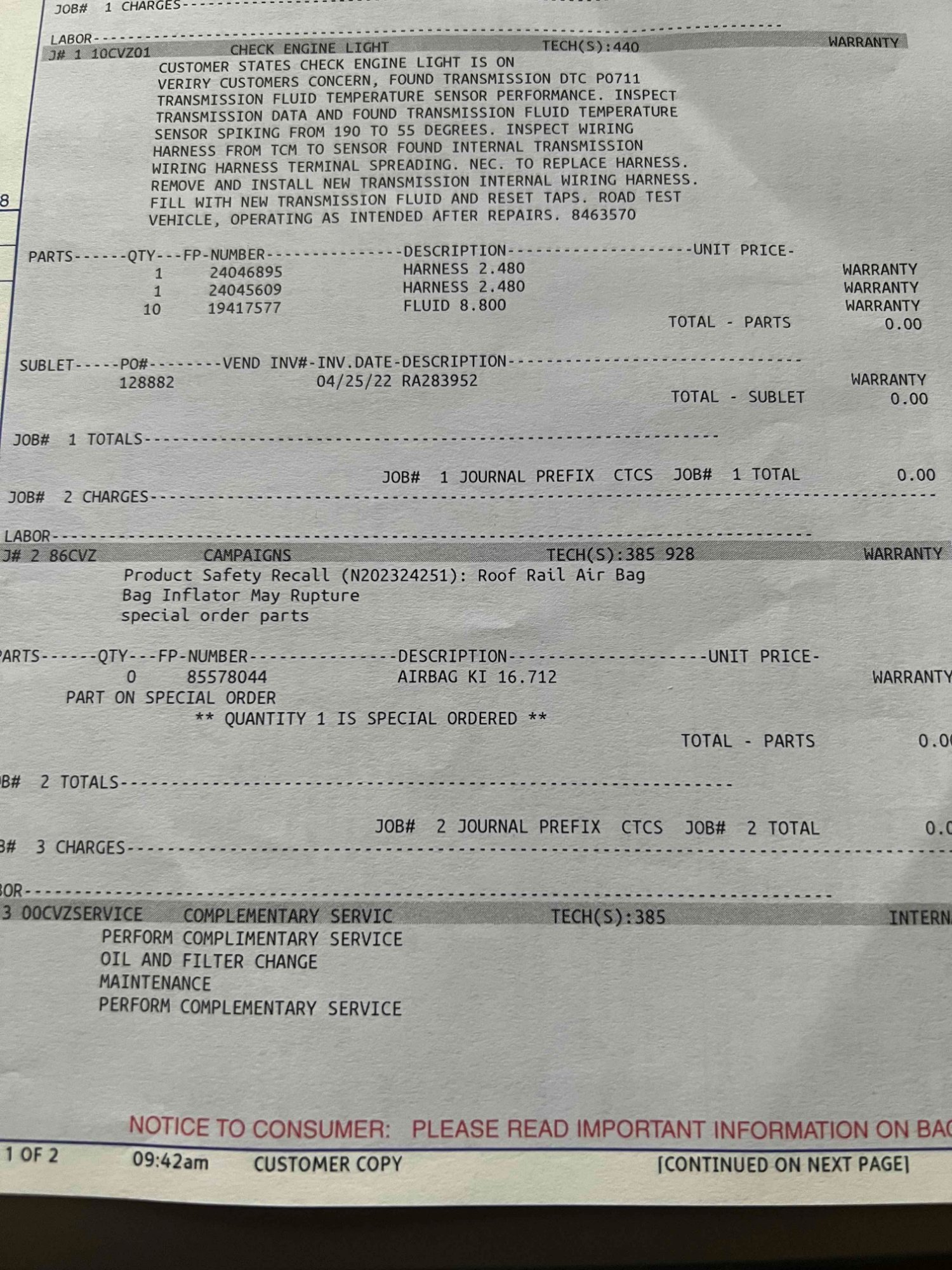

5 hours ago, newdude said:
If the harness has never been replaced at all before, you need both pieces because the original design harness is a one piece unit.  Once its been updated to the new two piece style, if in the event of future temp sensor failure you can then just buy the valve body half of the harness.
The valve body its a 50/50 if it has to be removed to change the harness correctly.  Depends on if there is a connector in a certain spot on the harness or not.
I understand much better now. I really appreciate your time to describe it to me.
22 hours ago, Sean_McNulty said:
Mine came out to $1057. The guy at service desk took off the diagnostic fee so that took $110 off. I can tell you that my truck hasn’t ever shifted as good as it did in the hour drive from the dealership. Feels like a whole new truck.
Thats exciting, thanks for posting the results. Really hoping these random rough shifts stop as well.

Had this done yesterday at dealer for my 2015.  Covered under extended warranty, which will expire in about 500 miles.
Seems to shift smoother than ever.   Probably also due to the clean fluid. The sensor was wonky for the last say 15k miles, but not bad enough to throw codes.
I had already drained and filled 8 speed on my own twice in the last 5000 miles (13 qts new fluid) then this - so the fluid is all fresh at this point.
It only took 100k miles to get this thing shifting nicely 😆!

Thank you guys for this thread! Bought a 16’ Sierra 1500 Black Widow with 6.2L and 1 week later threw 0700 and 0711. Been driving it for a month until I started to do research and landed on this thread . At first GMC dealer in Houston said no special coverage for my truck with 109k (bought with 104k), but called GM and they said I did have coverage . Getting it repaired Tuesday for free! Car fax shows this truck had transmission work done around 45k miles but at this point just waiting on lifter failure.

Had the trans issue now,  almost out of warranty and the dealer covered it.  2015 Silverado LTZ 6.2L 8 speed. Looks like I got lucky :). Temps seem a bit drastic, but I think that is why it was failing.  Been shifting badly for years. Tried to find the parts they installed, but not what I've seen in this thread.
