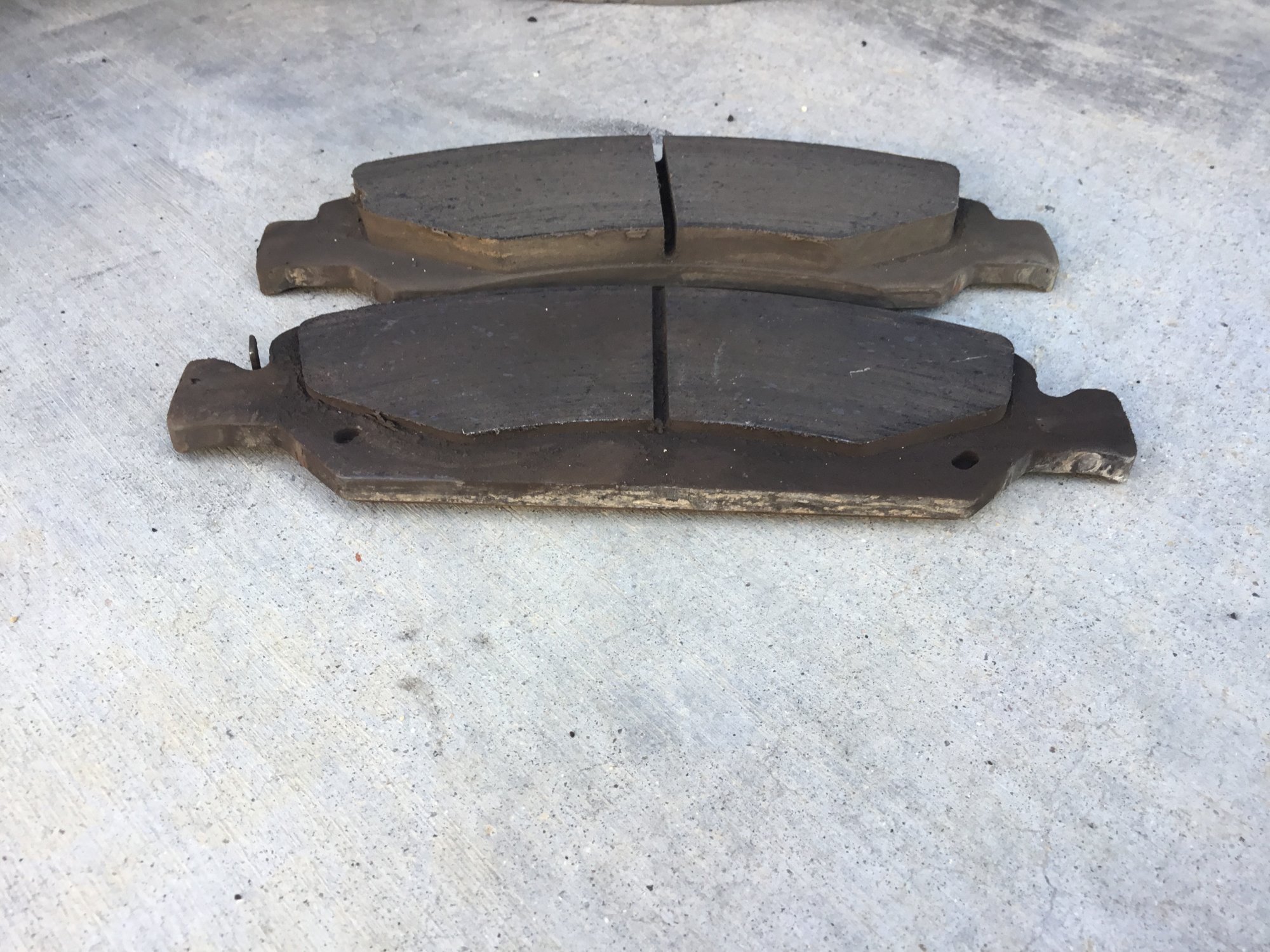

Stealership told me that my front right brakes were wearing oddly on my '15, a few thousand miles before the wreck.  "Bad news, brakes are almost shot.  Good news, you still have time to fix it before it will really cost you."
The next weekend, a couple months before the wreck, my son and I changed them.
Outside on top, inside below.  Wear indicator was not chirping, yet.
