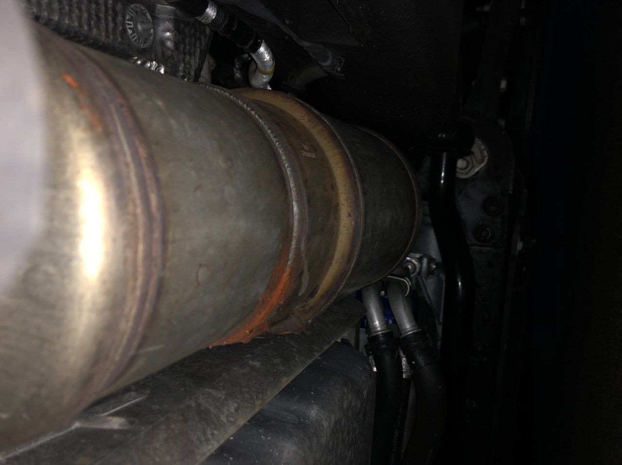

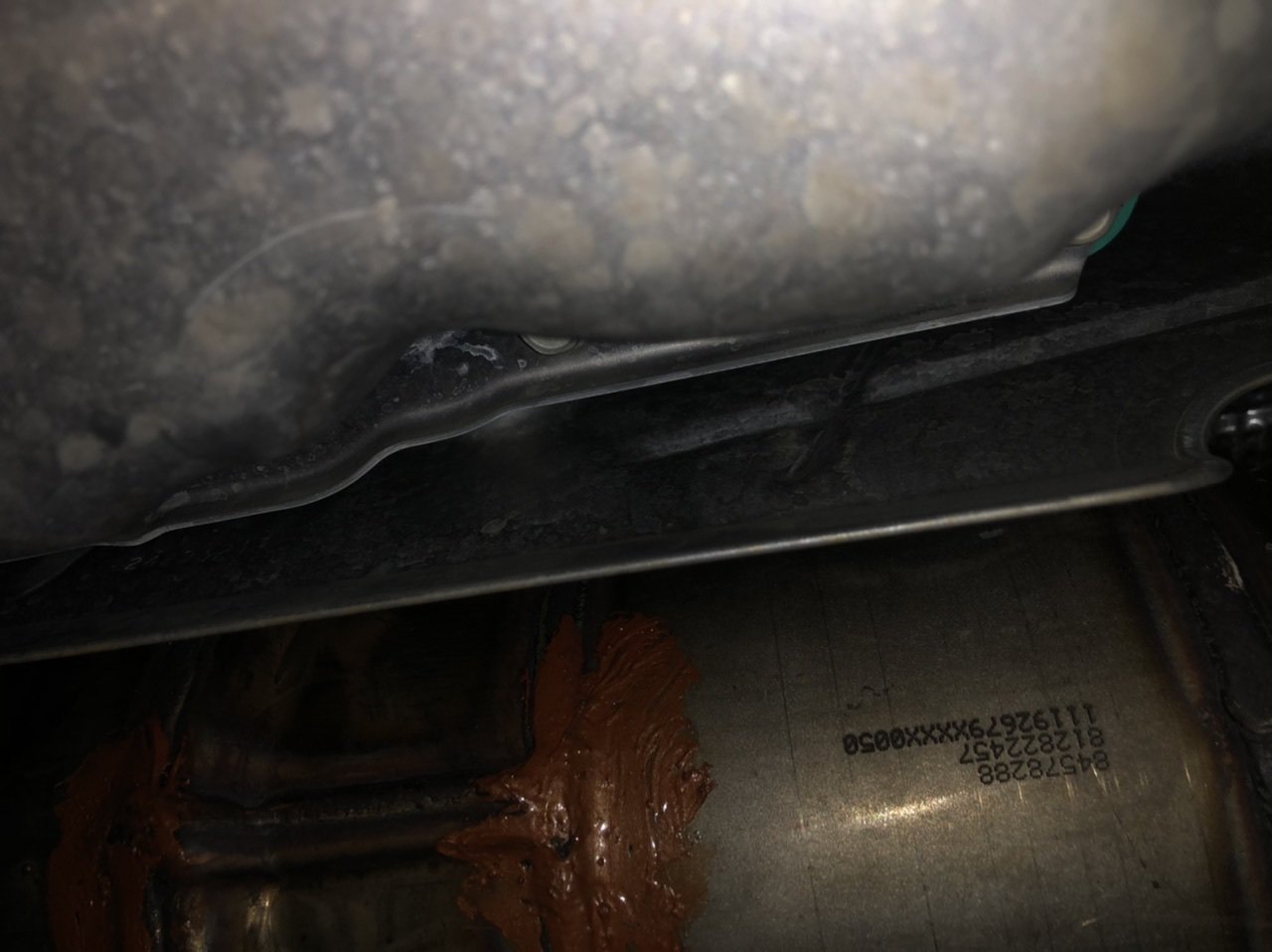

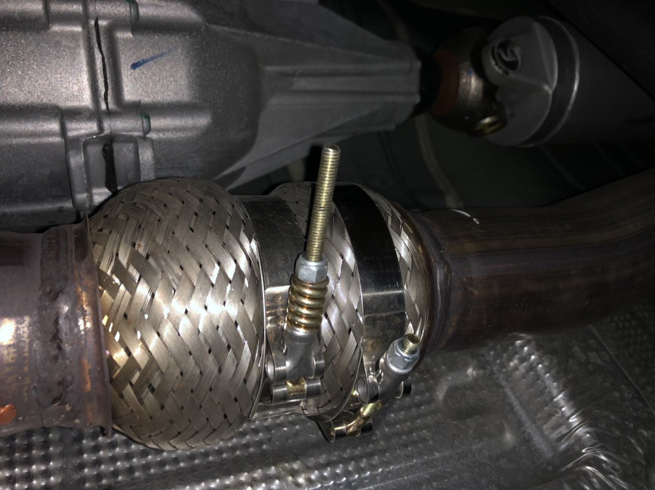

I have a 2020 Silverado Crew Cab with the 3.0 diesel purchased May 2, 2020. I currently have 20,800 miles on the truck. Since about 12,000 miles I’ve had an exhaust rattle that sounds like heat shield rattle, but has been getting progressively worse (intermittent DEF errors as well). Initially the rattle was intermittent and I could not see any contact with the heat shields, so I put copper RTV along the suspect looking welds on the DPF/SCR and exhaust clamp thinking it was an exhaust leak (it is, you can see where the exhaust leaks blew out the RTV). This did not help the sound and it was getting worse over time. So I put straps around the exhaust isolators to tighten them up. This helped for about a week or two, so I removed them. It has now gotten so loud, it sounds like the exhaust is about to fall off from a mile away. When I get under the truck, if I grab the Exhaust flex connector with my hand, the sound instantly goes away. So I put two Mishimoto clamps around the flex connector (one constant tension clamp). This pretty much got rid of the noise except for occasionally. If I remove them, everyone hears me in a mile radius. I would be fine with just keeping these clamps on, but in my state of Virginia, this means my new $56,000 truck will not pass safety inspection.

Not sure if this helps your cause, but seems there are some with a clamp issue...
https://gm-techlink.com/?p=13781
Particulate Matter Sensor Protection Tube Performance Diagnostic Setting False DTC
October 13, 2020
The particulate matter sensor protection tube performance diagnostic may set a false DTC P1488 (Particulate Matter Sensor Temperature Circuit High Voltage) on some 2020 Silverado and Sierra trucks equipped with the 3.0L Duramax diesel engine (RPO LM2). The Check Engine MIL also may be illuminated.
If the vehicle has DTC P1488 set, check if the particulate matter sensor is loose in the exhaust pipe. If the particulate matter sensor is loose, follow the diagnostics in the appropropriate Service Information.
If the particulate matter sensor is properly torqued and DTC P1488 is set, test the exhaust for leaks using the GE-52250 Power Smoke Diagnostic Leak Detector. Since the sealing bladder cannot be installed in the tailpipe upstream of the exhaust cooler, it’s recommended to use duct tape to seal the cooler.
Repair any leaks as needed and replace the particulate matter sensor.
If the joint shown is leaking (Fig. 23), the clamp may have bottomed out before sufficient clamp load was applied to the joint. (Fig. 24) The clamp should be replaced if this condition exists.
F23-particulate-1.pngFig. 23
F24-particulate-2.pngFig. 24
Refer to #PIP5748A for additional information.

The clamps I have to quiet it down are completely removable. I do not buy new trucks so that I have to walk or pay out of my pocket for a rental, especially when I can’t even actually make an appointment for it to be looked at. The appointment is to drop it off, they’ll look at it when they get around to it (according to them, they probably won’t look at it same day).

I am experiencing this issue currently. I am at 91000 miles and the expansion exhaust pipe must have cracked inside the wire mesh where you have clamps and is allowing a strange resonance. The dealer claims they have not seen it and the warranty will not cover exhaust since I am over the bumper to bumper. I recently just had a code P2C7A which is more than likely oxygen being detected causing the light. I am going to get the expansion pipe section replaced and then get the code checked out to make sure it isn't something else in the emissions system failing. I have about 9000 more miles of warranty for that equipment. It is frustrating there is apparently an issue and we have to pay for it.  I am posting this for someone else suffering from this failure.
