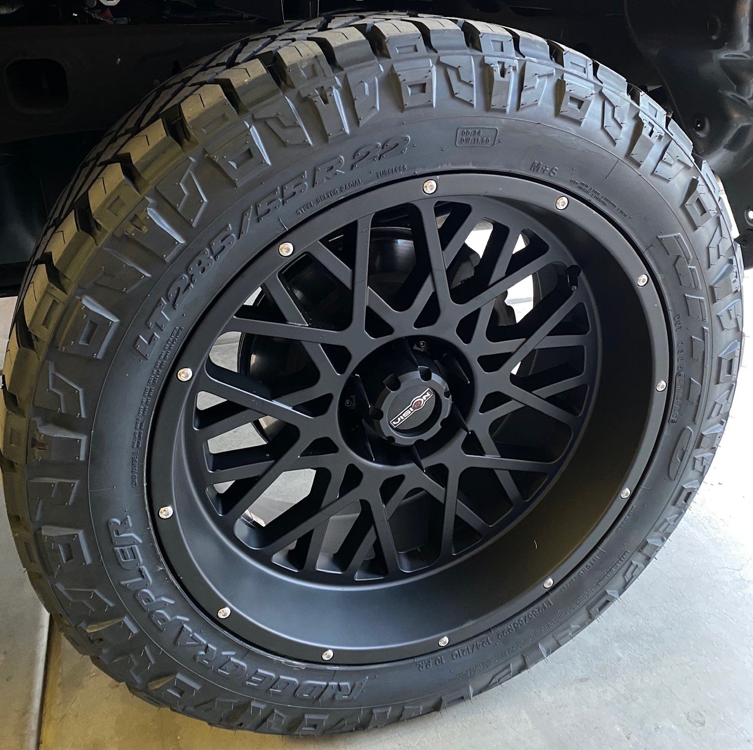

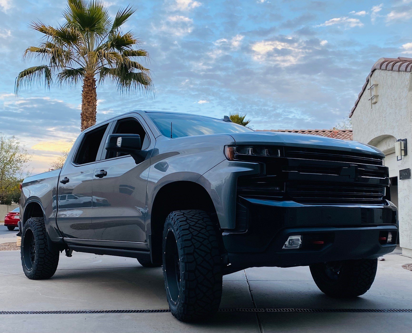

JUST LIFTED...Hot out of the shop!
2020 Trail Boss LT
2" Zone level w/ UCAs
22x10 (-19) Vision Rocker
285/55/22 Nitto Ridge Grapplers
  • Like 6
2020 Trail Boss LT
Damn that looks good!
Could you post up some measurements to the fender lips please? My truck stock is 39.5" front and 41" rear curious where you ended up?  Thanks!
I am sitting at 42-1/4" in the front and rear.  Additionally the pinch molding under the cab is sitting dead level at 18-1/2".
