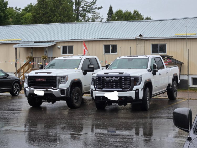

Pic taken today.
The Denali has a shark fin, but the other doesnt. Dont all trucks come w/ Onstar?
Edited by revrnd
1 hour ago, revrnd said:
Pic taken today.
If it's a basic truck they don't come equipped with Onstar so no antenna.
