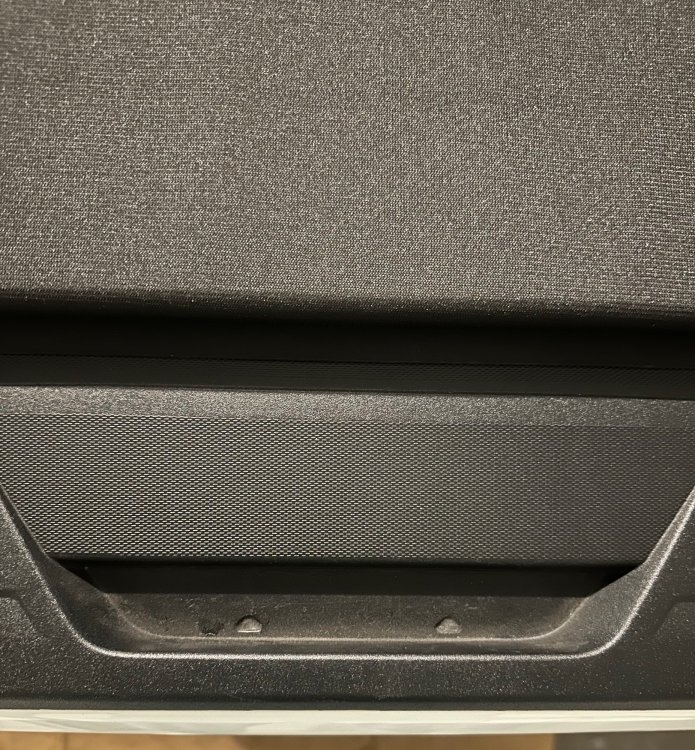

For me it's the main tailgate. First it started doing it after I had pressed the button. Clicking/unlocking over and over. Eventually would stop but every time I accessed the main gate by pushing the button it would start again.
Truck is going in for it's first oil change Friday. They are going to fix it then hopefully. I'm really surprised that this tailgate came out in 2019 and we're still experiencing this. Very frustrating.
Dealer replaced the switch in the tailgate and that fixed the issue with mine. Took about three weeks for the dealer to receive the new switch.
Thanks guys. I called ahead hoping they can get the order in.
Also, I couldn't take it anymore and disabled the switch. Hasn't happened again since I disconnected it. For me, it was the yellow wire pictured. You need to slide the red tab back in order to depress and unplug the switch.

Yea I disconnected it myself when it started happening so that it wouldn't damage itself. That's why i posted those pics above for anyone else having the issue.
