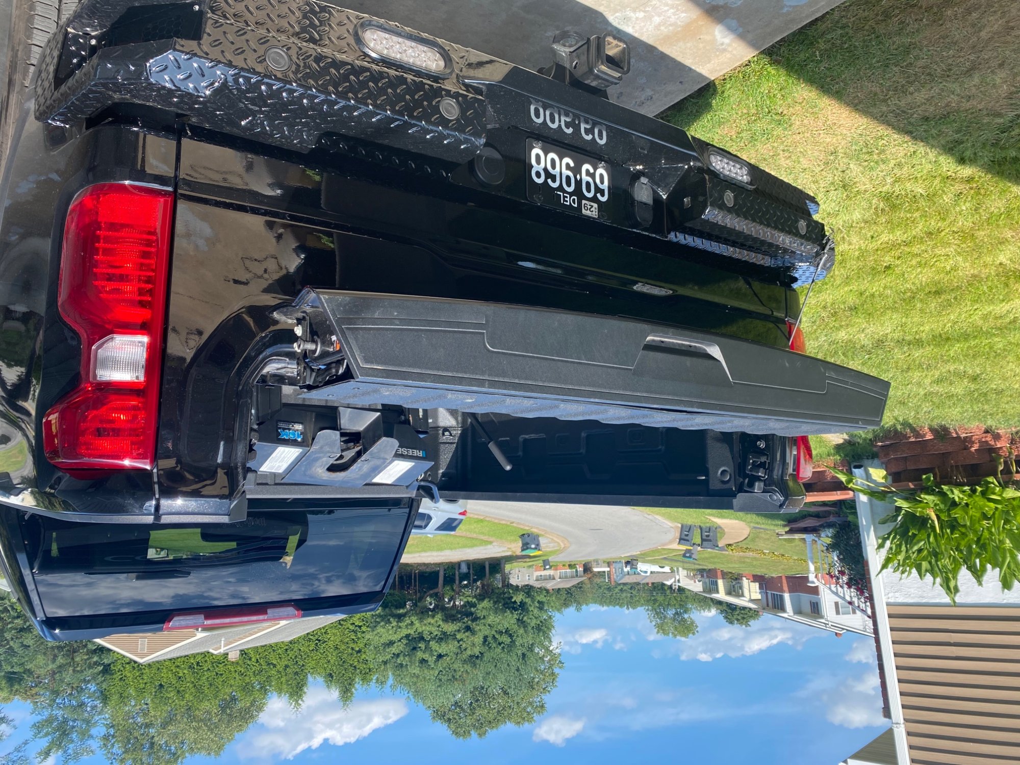

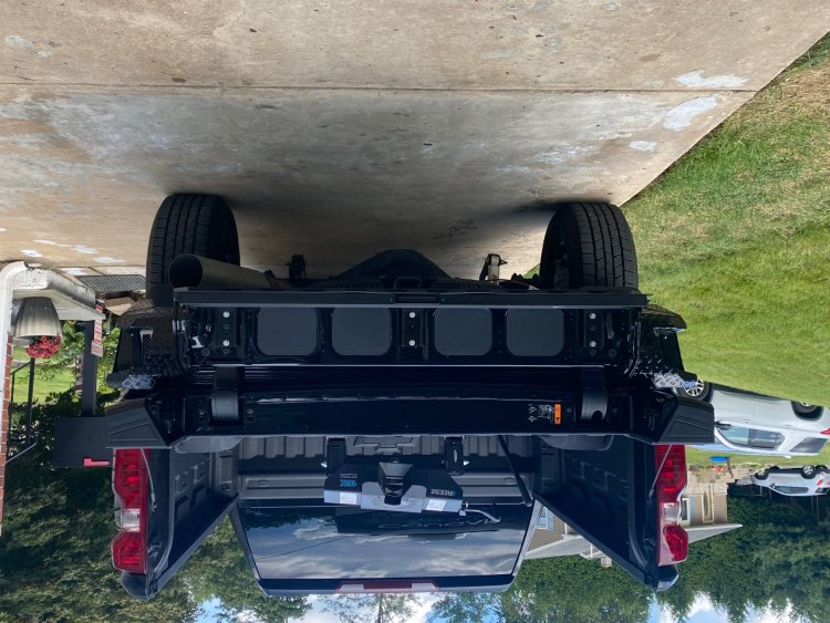

I was able to do a swap to a multipro.

Mike, did you have to do any rewiring of your harness?
I switched my tailgate and everything worked besides the tailgate step function, can't seem to get it to open and can't find anything in the forums or online. thoughts?
