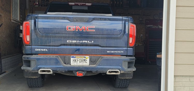

No problems with mine after 3 months. Love the way it really brightens it up when reversing at night.
