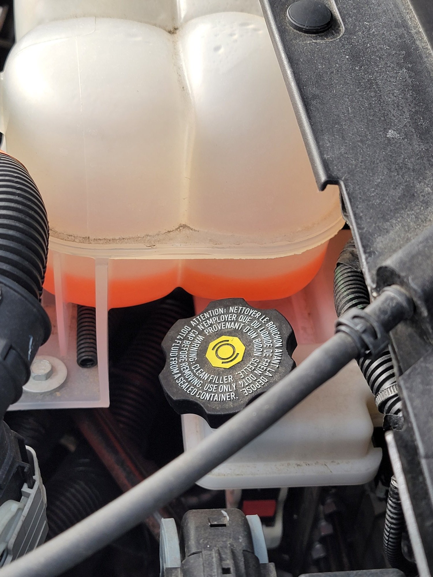

Have a 2020 LM2 Duramax with 14,600 miles. Since day one I've smelled antifreeze but reading on here, everyone seems to say it is nothing to worry about.  Well I am sure it is losing it now. When cool, it is about 1/2" below where it should be on the coolant bottle...where is it going? It's dry underneath. Motor is dry and no drips/puddles.
I've seen a few threads talking about this but never a resolution.  I am concerned about this and want to get it fixed because if it is burning it, I'm sure it isn't good for the DPF! I also think that by the time it does something very harmful to the DPF, it would be out of warranty.
I am going to make an appointment at the dealer, it's just that I don't have a lot of confidence in dealer mechanics lately,  especially if the scanner doesn't have a code to tell them to replace something.
Just wondering if anyone has had this and have gotten fixed so I can have something to push back with if they say they can't find anything and just fill it to send me on my and tell me to keep an eye on it.

I've been keeping an eye on it since new. It was at the correct level when new, but now it is low.
How many miles on it?
Has it ever been topped up (cold of course)?
How's the other tank doing?
14,600.
Charge tank is fine/maintaining.
Never been topped off
