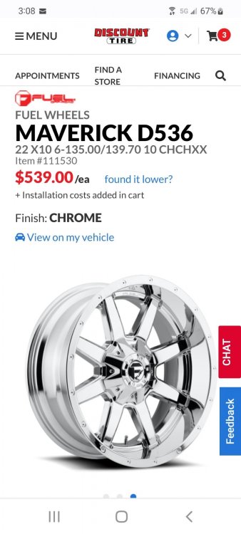

I'm ordering some new wheels and tires for my 2022 LTD High Country.
Going with Fuel Mavericks in Chrome of course.
22x10 +10 offset
Michelin Defender LTX M&S . I went wider but same diameter 305 45 22.

I got them at Discount Tire for $539 each.
Custom Offsets was a bit more.
F them.

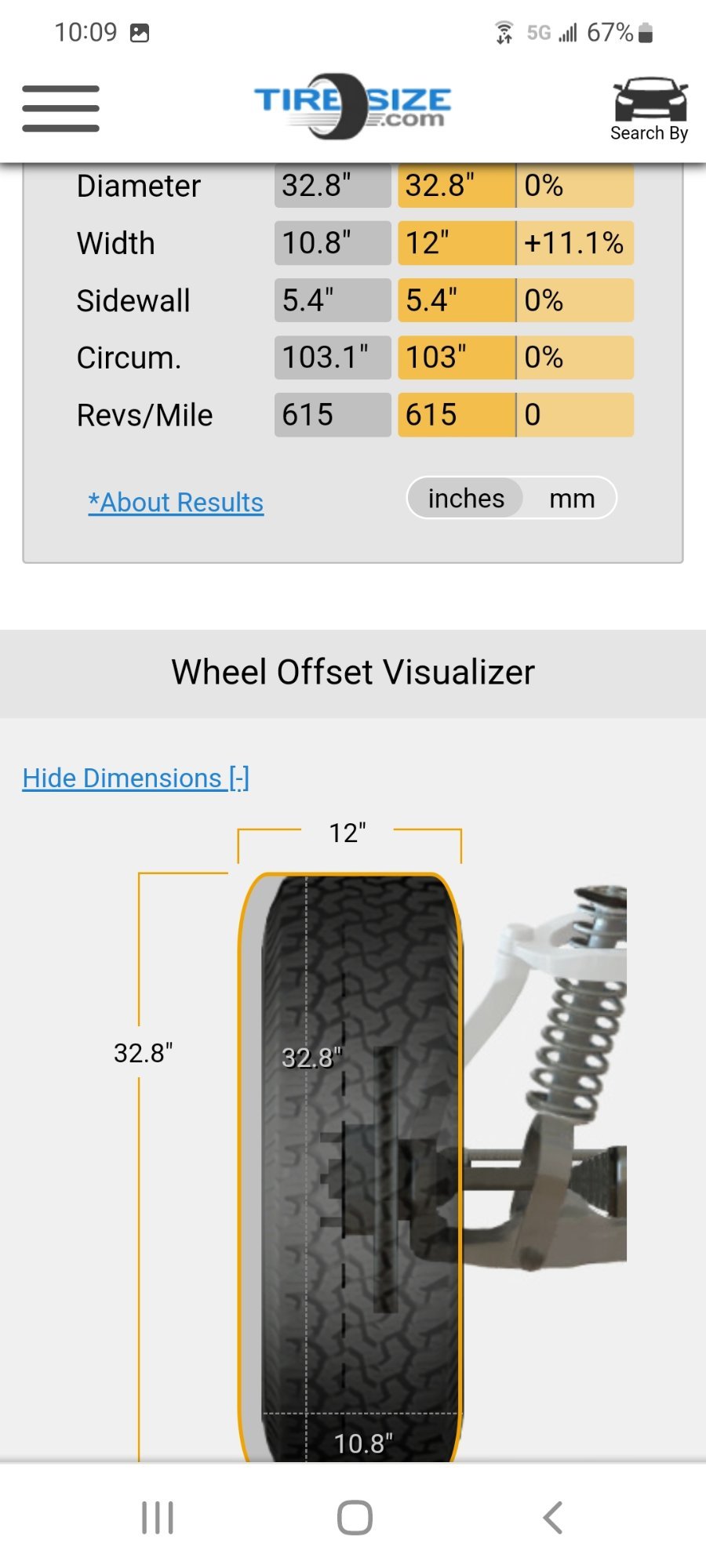

I didn't realize that site had a visualizer for offset! I found it a while ago and have been using it to find diameter and comparison to other sizes. I hadn't looked at anything for wheels.
Now you know

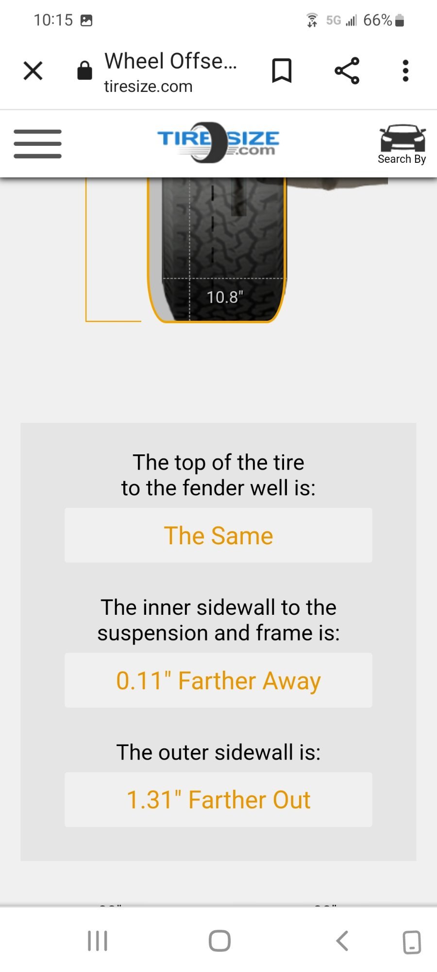

These are 22x10 +10. It should work without spacers no problem. I'm picking them up Friday.  I'll pop a front tire off and double check Friday night. Tires are same diameter but 1.2" wider.
It's the width that's going to cause it to rub slightly at full lock.
