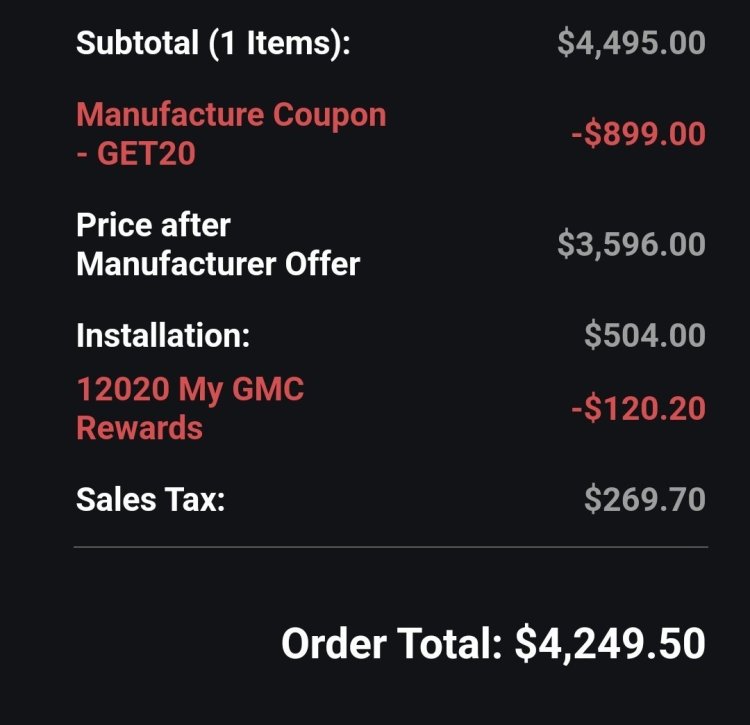

On 12/25/2023 at 4:29 PM, GETGONE said:
Not a bad price on labor. What was the total kit cost?
$3745.50 prior to labor.  Here's the breakout.Screenshot_20231227_201607_Gmail.thumb.jpg.34903250054e40c2dd48937f790c5313.jpg
Was looking at salvage parts... Rear suspension was the only thing I could find in the US and it was 1,600 delivered if I remember correctly.  Used eBay parts were about as expensive as new parts.  Pricey but this seems like a comparatively good deal with a warranty.

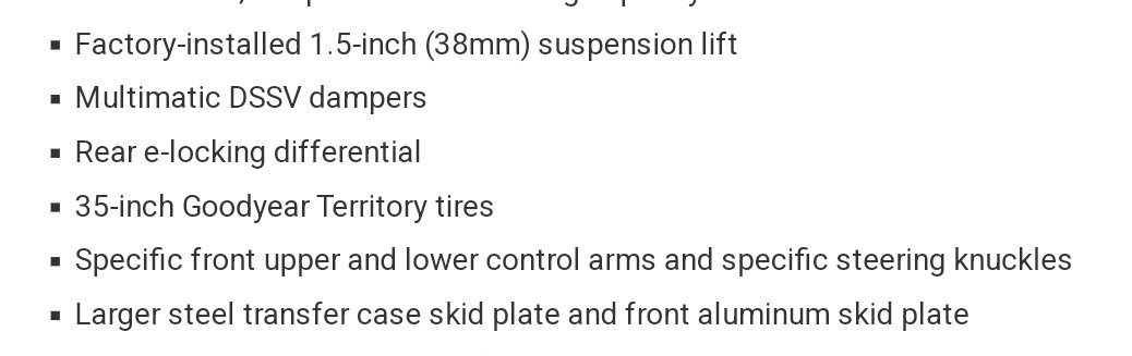

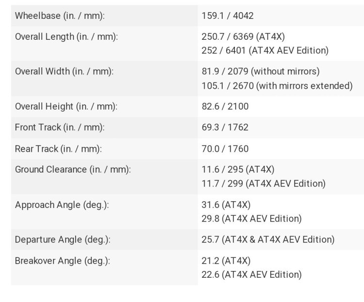

18 hours ago, jeetS said:
Do you need to swap out the control arms? Or any height as the stock ones are lifted?
I have an HD and Id like to swap to the at4x shocks ands wondering what I need
My understanding is struts and control arms.  Wider front track so don't know if there's a special fender liner or flared fenders.  Apparently unique knuckles, torsion bars, and leafs too.  HD at4x is my dream truck.Screenshot_20231227_202136_Chrome.thumb.jpg.0d223ddd69d3e21cd8d6a089c8b62ba3.jpgScreenshot_20231227_202241_Chrome.thumb.jpg.b78818610dd31f9e6b79f40198dedaa3.jpgScreenshot_20231227_202413_Chrome.thumb.jpg.d1961dc5a0eb8fb0f3653ff92bc8106c.jpg

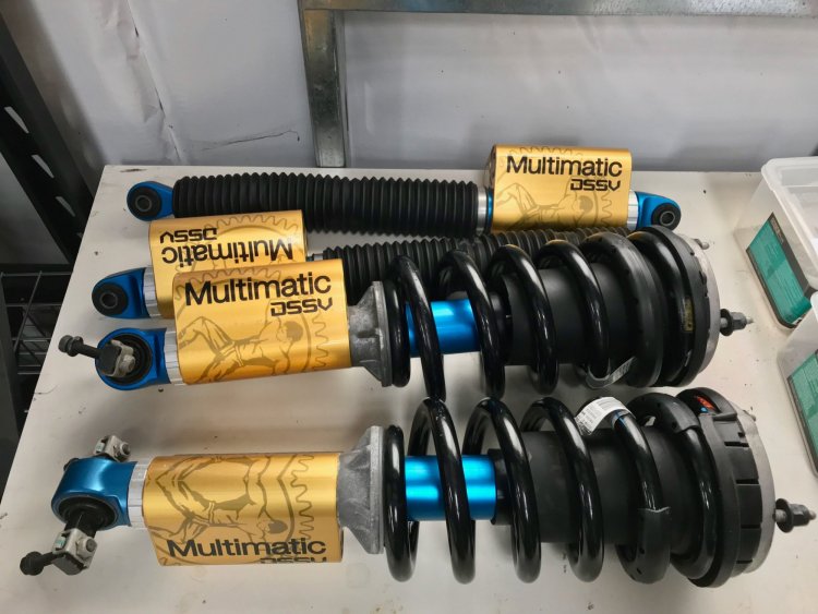

Hey guys,
I have a nice new set of Silverado/Sierra 1500 ZR2 shocks and struts for sale if anyone is interested.  Hopefully the link works: https://www.facebook.com/marketplace/item/1034166557846965?ref=search&referral_code=null&referral_story_type=post&tracking=browse_serp%3A28cfac86-747c-4d7b-a752-371efa70c9cb
As you know these are hard to find - the fronts seem to be unavailable outside of the GM performance kit.
Link works. Good price. Too bad I'm broke and unemployed as I'd love to have them and am in Michigan too!
