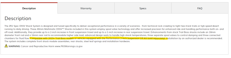

So I just checked GMC's accessory page, and when I set the vehicle to my 2020 AT4, the shock package doesn't show up.  Only for the updated body style 23's.  Any thoughts?
I had the same issue.  I am unaware of any design differences in the suspension mounts, so I'm not sure why.  I'm sure it will be figured out soon enough.

Notes say its good for 19 and up.

So I'm trying to buy this for my 19 at4 and dealer is saying it wont fit...

Comes with springs front and rear. You have to order for 22+ but it fits 19+ with factory lift. You can also piece together the kit. I got some of the stuff from junkyards and some from rock auto. Cheaper but a PITA.

Yea you can run without ZR2 shocks without the ZR2 rear springs. You'll keep the higher payload rating that way but probably rides a little rougher than the softer ZR2 springs. This is what i did.

I bought the rears from rockauto and bought the fronts from a junkyard.

What vehicle did you add them to?  I have a 2021 AT4 needing new shocks and am considering going this route if it’s a simple shock swap that I can do myself. I don’t want to buy new rear springs. Thanks.
I added them to my 21' AT4. Wasn't hard to do. The fronts are a little more involved but not a hard DIY.

Thanks. So you just ordered the 4x parts listed in this thread or the full set offered by GM?  I can’t find the fronts listed on any site but the full set is list around $3600. Where did you find your parts?
I purchased a set of new take-offs from a private party. It was listed on FB marketplace.
I didn't change the rear leafs as I didn't want to monkey with my tow rating (I tow my 5K boat regularly).
