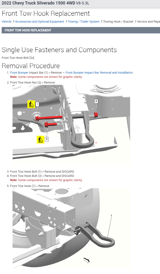

Has anyone removed the tow hooks from their 2022 refresh yet? I found a pair of red ones that I'm going to pick up. Just curious if it requires removing the bumper completely to get them off.

To be honest you could probably remove or unbolt some of the underbody plastics and unbolt them without removing the bumper
The accessories install sheet shows the bumper does not have to be removed to replace the tow hooks.
Make sure the ones you are getting are for the refresh, they changed the design of the mounts so the 19-22 ones won't work.
If you can reach the bolts without removing the bumper, then there is no real reason to remove the bumper.  I pulled mine when installing the winch mount but I don't remember whether or not I could have done it without removing the bumper.

After looking at the posted instructions and under my truck, the bumper will have to come off because of the extra cooling the 3.0 has.
