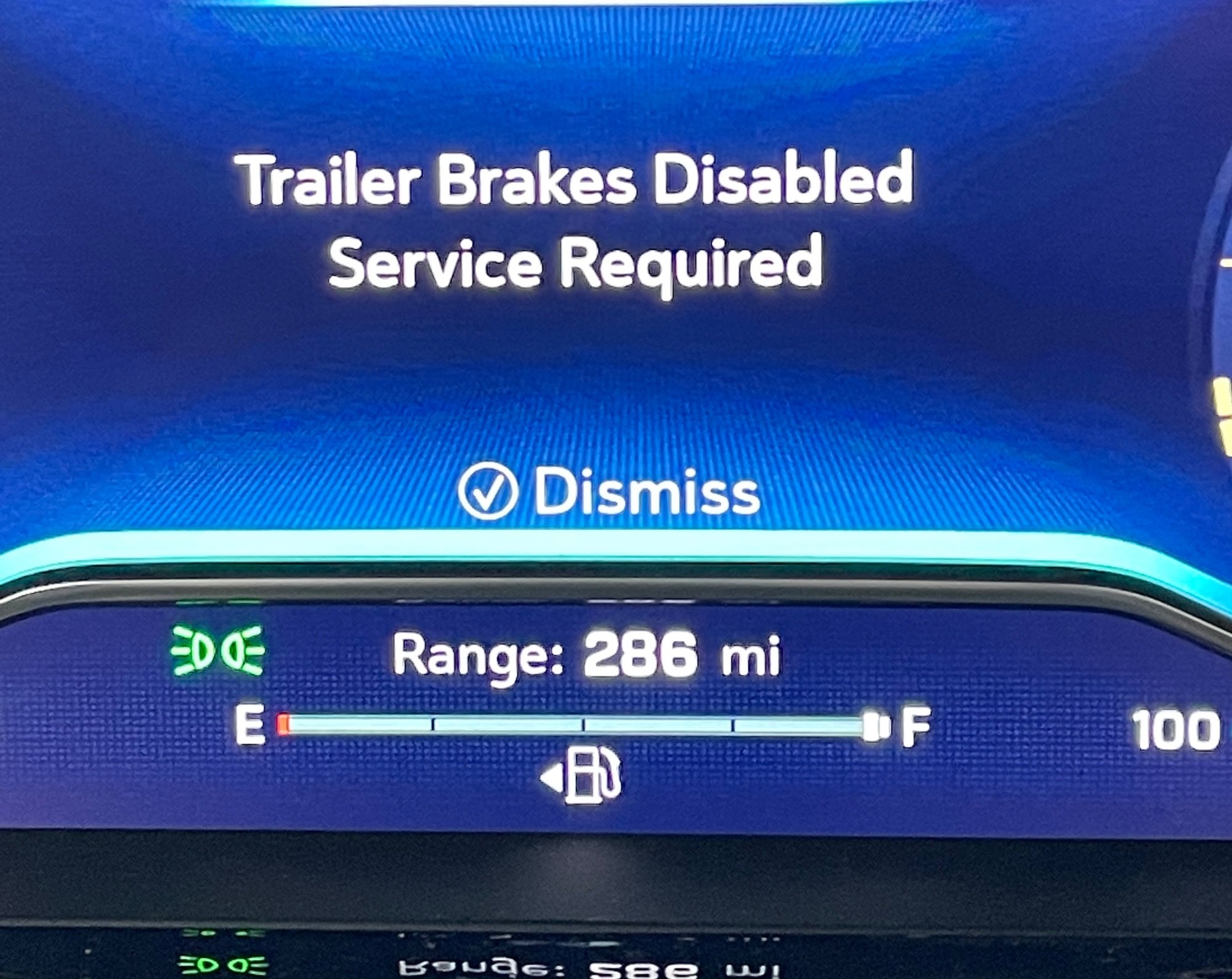

I'm having the exact same issue sans the camera issue.  Same technical bulletin given to me by the dealer and C159C code. My dealer gave me the information, I called GM to ensure I opened a case - I bought my 2022 refresh 3.0 RST to tow a small camper for my family and I.
The brakes work fine for a few minutes - then they throw a message onto my info panel "Trailer Brakes Disabled Service Required".

edit/update - The external brake controller did not work.  I've photo the message I receive when trying to use the integrated controller.
This is the exact scenario that mine happens. Works for a few minutes then boom goes to crap.
9 hours ago, Shield1984 said:
This is the image haunting my dreams....
