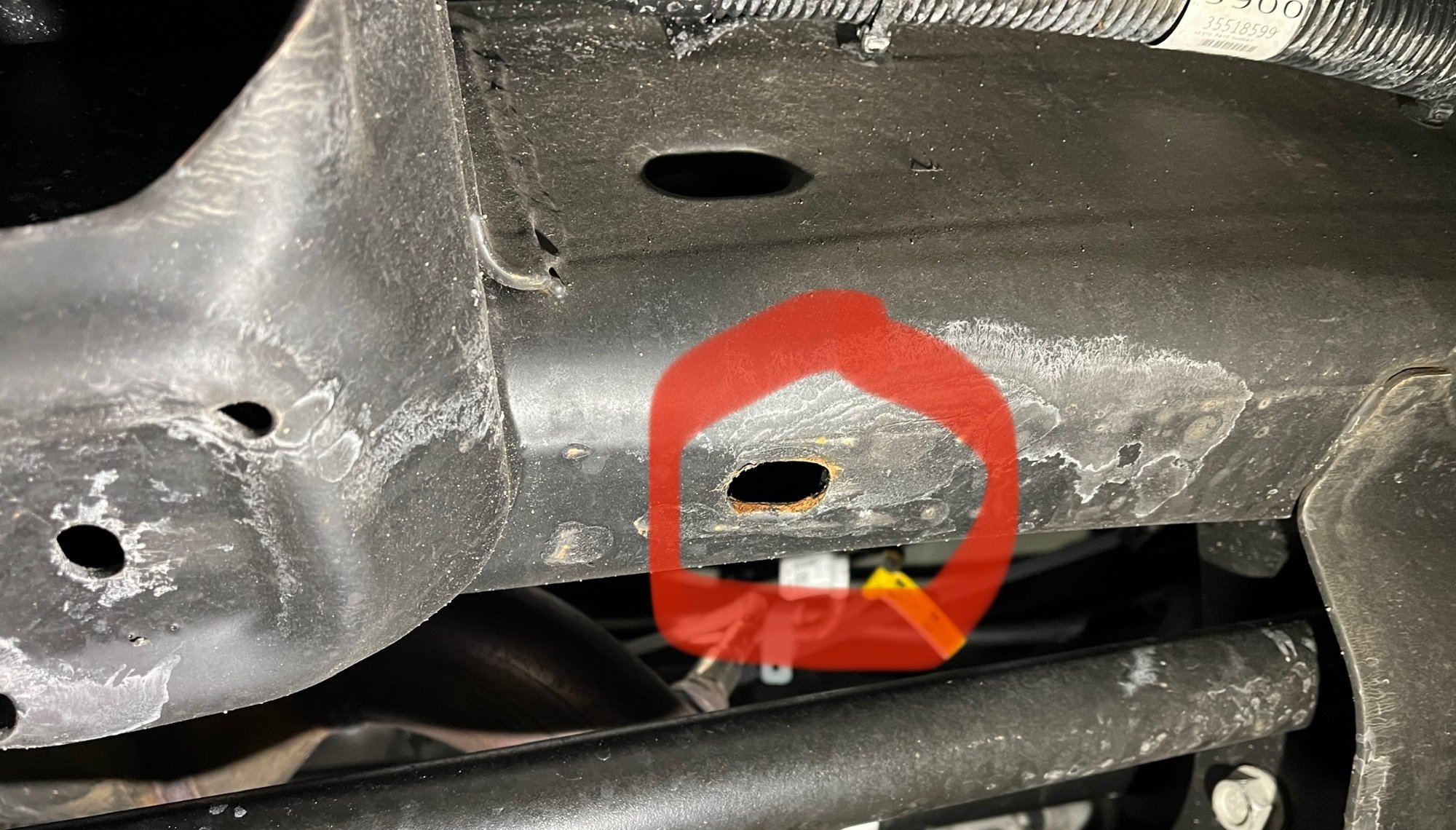

Pryme Posted February 9, 2023 Posted February 9, 2023 No, not the crappy Alec Baldwin movie, the stuff that creeps it’s way into a new truck! so I have been super vigilant with fluid filming all non waxed areas, including inner body panels even taking the plugs from the rockers and in the bed to get the inner wheel wells. not a spec of rust on any of those places. I didn’t fluid film any waxed areas because I read some ppl stating it could ruin the wax. I applied some fluid film on one small area of waxed metal about 5mo ago and I’m happy to announce fluid film has not done anything to the wax. This area has been hit with a pressure washer, not super close but casually multiple times. the reason I mention this is because there are multiple places on the frame and other waxed surfaces that have small amounts of surface rust forming. I’ve never seen that on other non waxed trucks or cars that use a paint or E coat during the first year. I plan on getting a couple cans of nox rust which is whats on the frame to apply before next winter. Has anyone done anything to their trucks for rust issues or to prevent it? I know you guys in the warm states don’t have issues although I’d bet near the ocean you could. here are a few pics

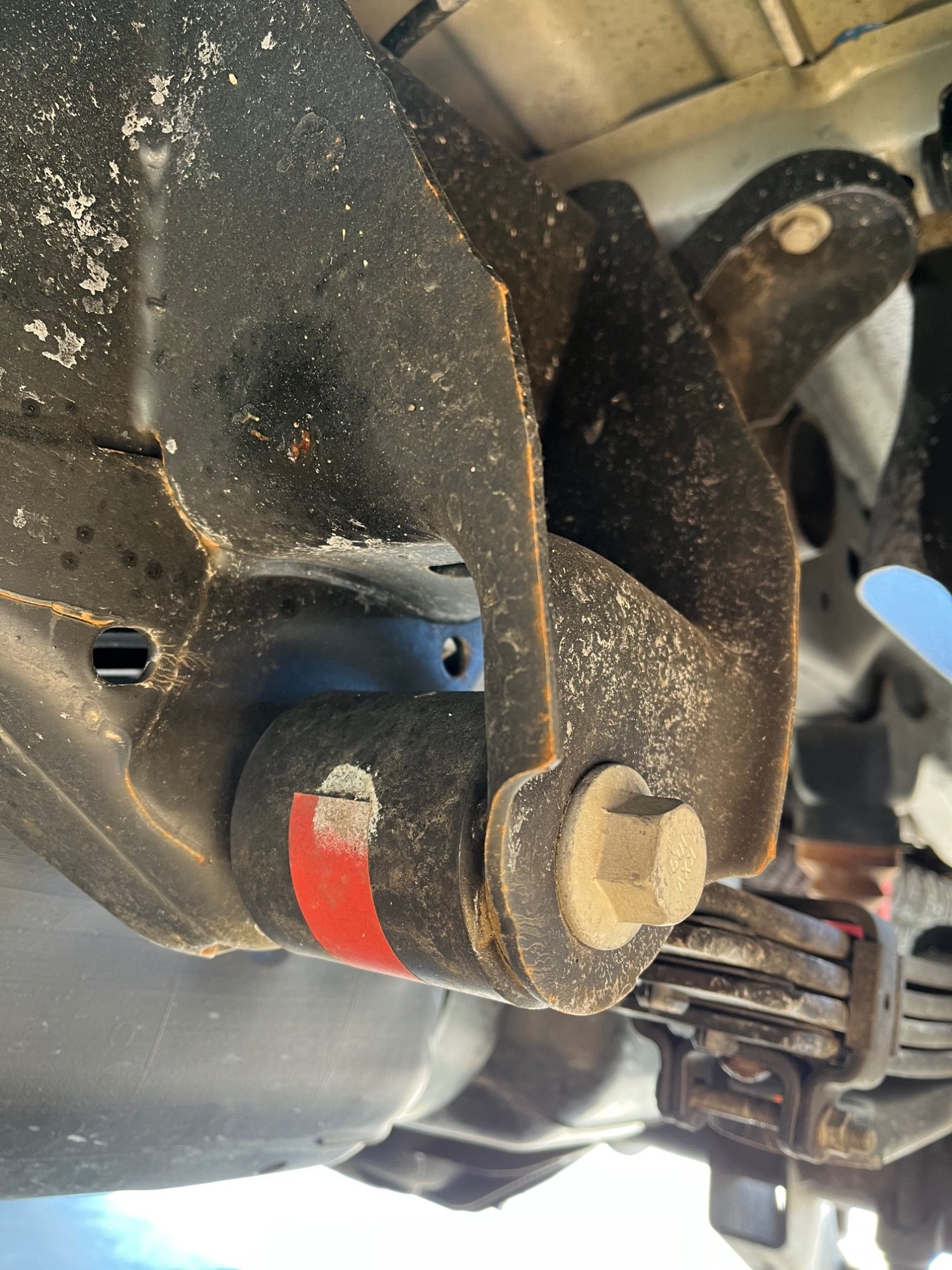

Pryme Posted February 9, 2023 Author Posted February 9, 2023 That white dust? No, Tony Montana didn’t throw his stash out the window. Yup that’s salt guys. Us cold weather folks know it as the enemy. pic of the rear diff shows it looks spotless since it’s had fluid film on it from day one. 1

Pryme Posted February 9, 2023 Author Posted February 9, 2023 1 minute ago, 64BAwagon said: I did everything on my 21 with FF including the frame. I have not noticed any degradation of the wax coating. So you did fluid film your whole frame? Good to know. And it’s probably fine right? to really see any you have to get under the truck because it’s on some edges and at weld point crevices. take some light pics around the rear leaf shackle attachment points. Seems a few spots there. of course multiple parts in the front steering are raw steel and get surface rust by looking at them. Not sure why those parts are not painted. I know they don’t add to the structural integrity of the truck, but still.

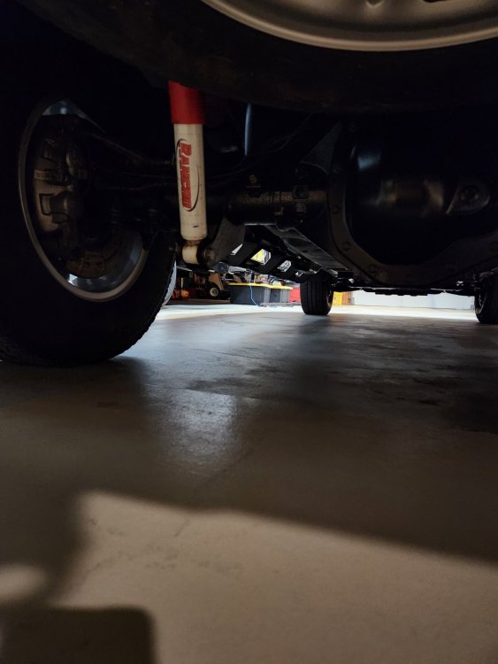

64BAwagon Posted February 9, 2023 Posted February 9, 2023 Another pic. The diff cover was painted when I pulled it off for service. 1

Grumpy Bear Posted February 9, 2023 Posted February 9, 2023 Normal. Wax doesn't like sharp edges and doesn't creep well into lap seams. It's not a failing of the wax. It is its nature. Lanoline penetrates. Instead of sealing 'pinch weld' areas it seeps into them. I've tried for two years now on the wife's SUV the scrap and paint routine and every year is blisters another level. Done and dun with that method. Lanoline is it. 1
