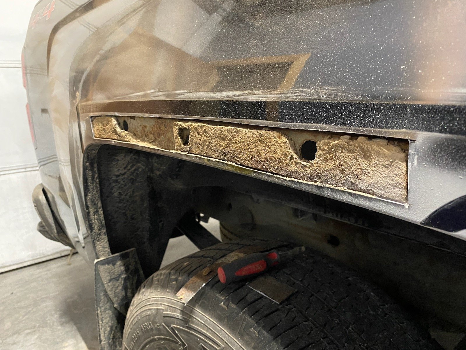

From the thread:
No wonder I am getting rust over real wheels with 3 stupid holes put in there by Chevrolet!

Why do they put random holes there? And is that sound deadening in there? So are you welding in a patch?

Not my truck. It belongs to @Diverjer.  Pulled it from his thread as it was on point for this topic.
No... not sound deadening. Packed in sand, salt and whatever else finds its way through those holes.
I use a product called Rustfighter by 3M. It comes with big vacuum line wands to get into the inner fenders. I remove tail lights, blow out the dirt, then apply it. Its basically a wax coating. I also dont drive the vehicles I care about in the winter until some heavy rain has washed the salt off the roads. That also allows me to purchase 2wd since I dont drive them in the snow. I just drive cheap fwd work cars instead.

There are supposed to be plugs in those holes.  There are actually 4 per side, trucks back to 2007 have them (beds are the same except for outer panels and tailgates '07 to '19).  I have seen it where a quarter panel was replaced and the body shop didn't put the plugs back.  They are there for a reason.
