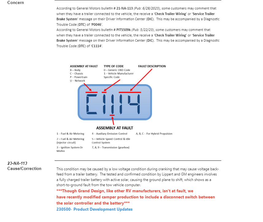

mcausey Posted August 25, 2023 Posted August 25, 2023 (edited) Grand Design RV has a fix out that adds a Battery disconnect between the Solar controller and the battery until GM fixes this crap. Mike Edited August 25, 2023 by mcausey 1
Rototerrier Posted August 25, 2023 Posted August 25, 2023 Great news from GD. Thank you for sharing. Basically doing at the factor what all of us have resorted to doing on our own.
