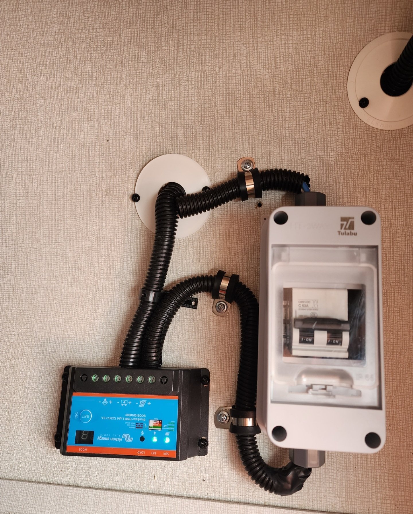

I wired in a breaker between the solar panel and charge controller today to give me the ability to disconnect the solar. We have a trip coming up at the end of the week, so I'll report back on whether that helps. The more of us verifying this the better!
Just made it to our destination and had zero errors/notifications in ~350 miles with the solar shut off. Hopefully GM comes up with a fix soon, but in the meantime it's no big deal shutting off the solar when driving. Glad it's nothing worse than that, at least.
