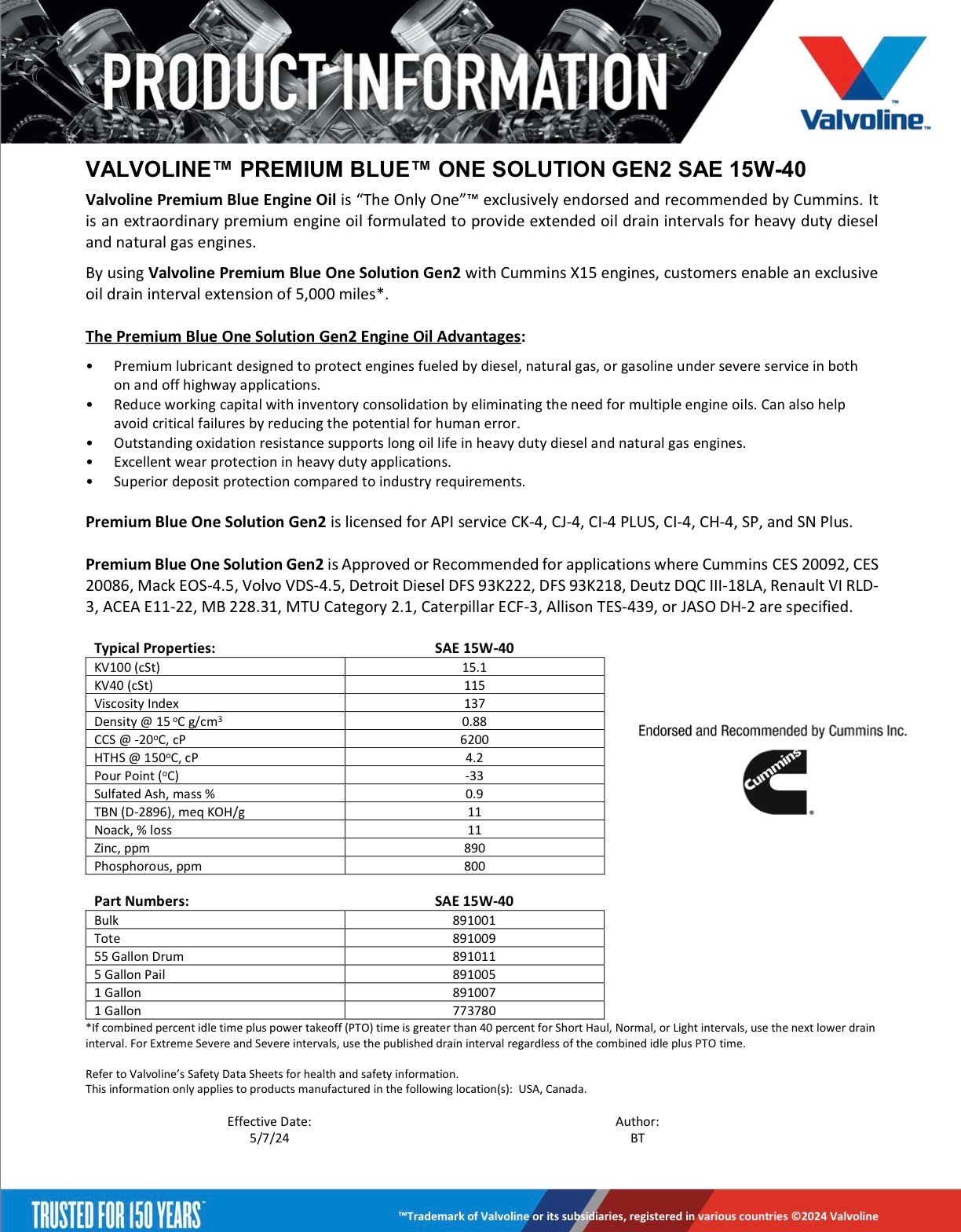

This will help. Compare to other products. 10W-30 $19 US  a gallon at NAPA
Edited by customboss
2 hours ago, KARNUT said:
Maybe I didn’t read enough. Was he saying don’t add water to motor oil? It must be an additive he’s talking about. I just don’t like thinking that hard. Damn it now my head hurts.
Here’s 15w-40

So here's a question which I don't believe I had asked, or perhaps I had in a round about way. This premium blue, being that it is an SP rated oil, has it been tested with whatever method is being used to determine if it would pass the LSPI test and actually work without damaging the direct injection L8T or for that matter your 4 cylinder turbo 1/2 ton engine which might be more touchy yet because of the turbo ?. Obviously the oil does not carry the Dexos approval but the fact it is an SP oil, if it could work. As it just so happens you have the perfect test vehicle right in your driveway if the testing has not been done yet 😋
LSPI protection is a requirement in obtaining the SP certification. Valvoline happens to have a lab other blenders use to certify their oils. One of few. Mobil also has their own.
The SP certification has a limit on the amount of calcium that can be used, the chemical that has been given credit for causing LSPI. So a new blend that meets the limit and has 'read across' on base oils can get a certification without actual testing if all other requirements have been met. Full testing cost ignorant amounts of money that would strain or break the resources of smaller blenders to this 'read across' is used quite often.
I have no direct knowledge which method was used for the product you are asking about. But it is Valvoline....
