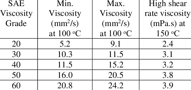

I think that if you choose an oil with enough HTHS viscosity and change it often enough to prevent deposits you will get great life and service from you powertrain. With self-oils, even with enough viscosity, OCI lengths will be SHORT. Much shorter than the OEM OLM recommendations. 2 to 3K miles at best. Dilution of the varnish precursors is the only tool you have with a non-polar oil.
Except for the Mobil 1 product on my first list, they, shelf oils, haven't any, or very little solvency and as such cannot prevent gasoline varnish from impacting ring integrity. THAT is important when gasoline is the fuel. Those oils I listed have solvency, enough to hold at bay for some and even clean for others.
That said what you used were products the increased viscosity in an already vicious oil.
