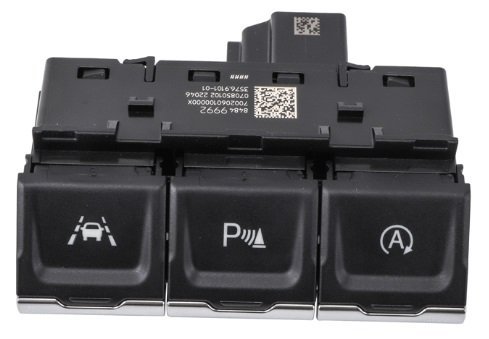

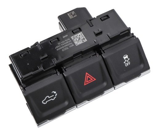

Switch bank.  On these new interior trucks (2022.5+up) the switch "bank" is made up of 3 or 4 individual switch sets, depending on the options of the truck.
The two below are using a VIN from a 2023 Denali 1500.
Notice this section for example.  Hazards, tailgate and traction control switch.  This one is the "S86 Vehicle Stability Control Switch" in the GM connector end charts.  Unplugging this will result in a code for the traction control switch and quite possibly all sorts of service stability, traction disabled and various other lights and warnings.

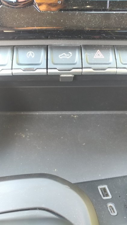

I guess my question is how the heck do people bump this switch at all?  Are they sticking a freaking laptop in their console?  I've never once bumped that button unwantedly in my truck.  Ever.
You shouldn't have said that, cause you just jinxed yourself. It's not a matter of "if" you bump it, it's a matter of "when" you bump it. Just hope you don't bump it when you're backed up against a concrete wall in a parking garage. The way that button works is a nightmare. It's simply too easily bumped. I've had mine bumped many times, and here are a few:
- While simply putting an eyeglass case in the storage area, the case glanced off the button and it oened the tailgate. Luckily I had to back out of the space, and the camera showed the ground. Took me a minute to realize what happened.
- While reaching to retrieve a piece of paper, I reached over the shifter and bumped the button. Obviously, the placement of the shifter increases the chances of the button being bumped, unlike in prior year models.
- While loading up for an outing on my boat, a passenger temporarily placed their water bottle part way into the drink holder, thinking they would seat it properly when we got in to go after loading. From the jostling of the vehicle while loading up, the bottle tipped over and bumped the button. Luckily, the tailgate clears my trailer winch stand.
- While running a cloth lightly over the center stack while cleaning the interior, the pressure of the wipe was just enough to trigger the sensitive tailgate button. (Interestingly, the iginition button was designed to be pushed with much more pressure/longer duration to work. In fact, I've found that sometimes I push it too quickly and the truck stays running. The tailgate button, on the other hand, is made way too sensitive, and if you can't turn it off, it should at least be programmed to 2 or even 3 presses.) It is so sensitive that, as I mentioned in an above post, nothing can be wedged between the button and the underlying trim that will keep the button from working. Even with something wedged in that tight space, you can easily still press the button just a hair because the trim below just flexes downward, which is enough to trigger that tailgate.
Those are only a few instances of the many times it's been bumped.
Now, if someone can help us figure out which wire from the button goes to the BCM to trigger the tailgate latch, we'd be in business.
Thanks for digging these up.
The button is on it's own circuit even though its wires run through the all-encompassing harness plug. Do you happen to have any resources that might help us find out which wire is the trigger wire that runs from the button to the BCM? I'm not afreaid to admit that I am just not well-versed enough with schematics to figure it out myself.
