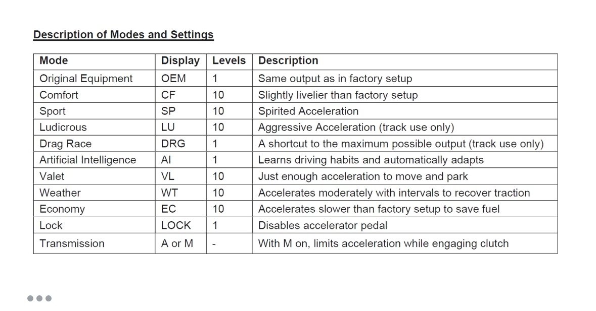

I asked what the AI mode does.  This was the answer
The AI mode automatically chooses a setting and adapts based on your driving habits. AI mode works by monitoring your habits of pedal displacement and rate and builds a time average of the corresponding response level you desire. It works similarly to the fuel trims, where you have a short-term behavior that over time sets a new baseline for the long-term behavior. It will start in the middle of the range near SP5 (invisible to you) and depending on how you drive it might go up or down with time. I'm going to attach a chart that describes each setting as well and if you have any other questions please let me know.

as for the throttle body, probably similar to the one you installed.  Only slight performance gains.  Should be some slight MPG gains but maybe hard to say for sure.  As for the TB controller, No performance gains but just feels like it because it accelerates harder for the same pedal input.  Just a fun factor.  MPG probably drops because now you are accelerating harder all the time.  But it's fun.  Could probably gain MPG  with the economy mode.
