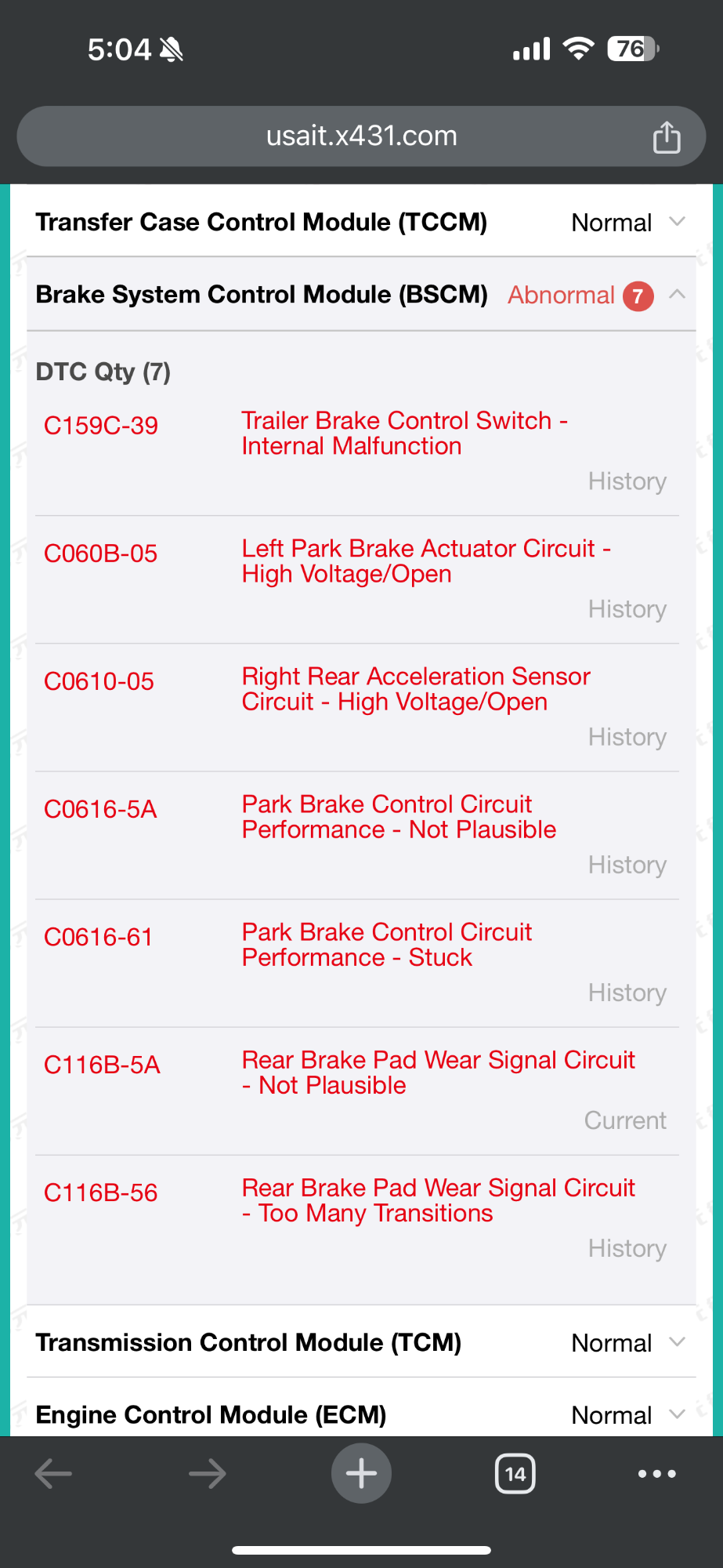

You absolutely correct, for some reason the electronic brake causes a lot of drag. I recently bought launch CRP129x and was able to reset the Brake Module. I got a lot of codes and once I reset it now the dash shows me the brake pad remaining.IMG_5739.thumb.png.e82b0e349b53d39b0bccab62da1bd5d6.png
interesting, although i haven't scanned mine in awhile, last time i did i had no codes. i used gds2 to scan my truck. will scan it today and see if there is something there
