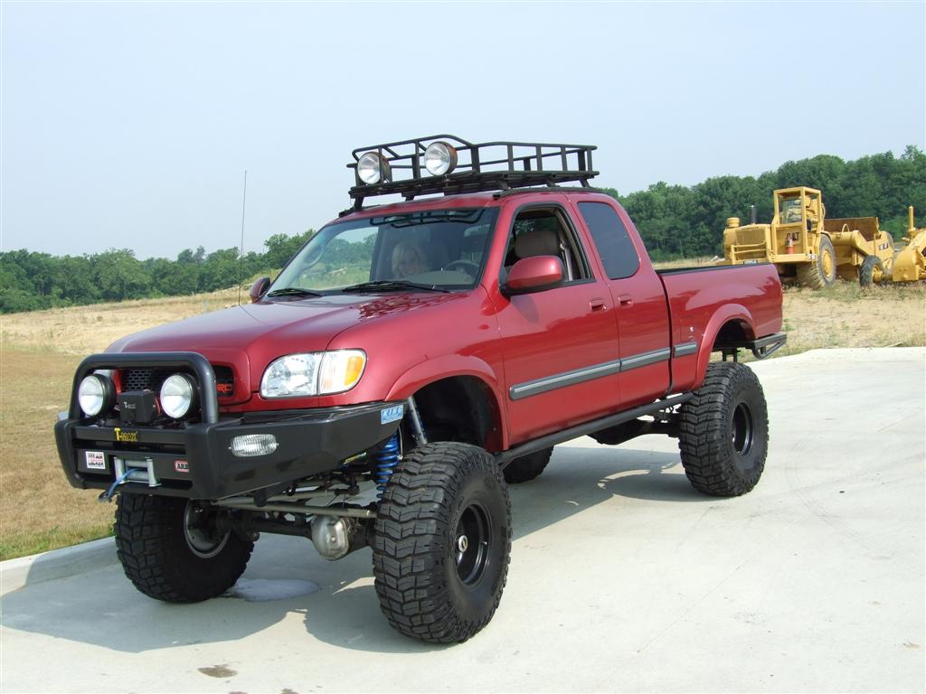

post pics of all of your rides... i hate toyota but that tundra you have is awesome i remember seeing pics of it.
OK, OK Pics of all rides, Man you guys are demanding! :cool:
Toyota Tundra has a home made 5-link coil over with a Dana 44 high pinion sitting on 12" stroke King shocks. Both axles have 4.88's and ARB lockers. The rear is custon also. Homemade flipped shackles and custom springs with 14" stroke Bilstien 5150's. Chevy brakes, headers, supercharger, ARB bumper and other stuff. Rock rails, rear bumper thing and roof rack is also home made.

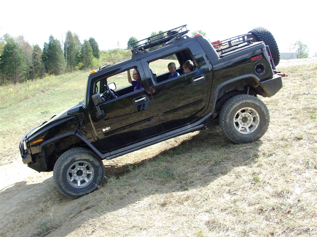

H2 is all modded out, but I am trading it on the EXT.

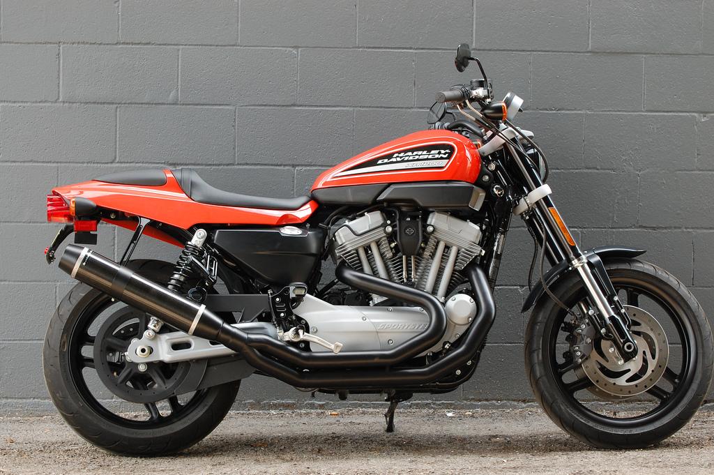

Oh, the Harley isn't a truck (obviously) but sounds like a cammed chevy!

I did the same mod on the 6.0 H2. Gains there were questionable...but...
When you add 30 or so horsepower to a 6500 pound boat, you can't really see (feel) it all that much.
The hummer pulled better after the mods, but gas mileage remained a very dissapointing 11.3 and required higher cost 93 octane.
I have heard and will agree, if you buy a hummer, just "shut up and buy the gas!"
