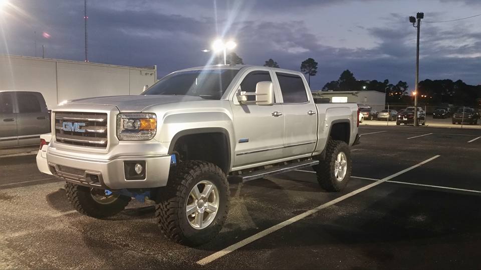

New to the Forum, but here's my 2014 Sierra All Terrain Z71, 13" total of lift, 10" Suspension and 3" Body on 38x13.5x20 stock rims.
Mods so far: Volant Cold Air Intake, Throttle body spacer, BullyDog programmer, and for exhaust I cut the 3rd cat and factory muffler out and installed a Flowmaster 44 series muffler in the factory location with a 90* turn down right out the back of the muffler.
Still have the stock 3.08 gears but with taxes I'm installing 4.10s F&R.
I still tow my 29' toy hauler with 2 RZRs in it.
All RC Suspension Lift and Powder Coated Blue.
Let me know what y'all think.
Thanks Zack
Well I like it! You have a good looking truck for sure.
