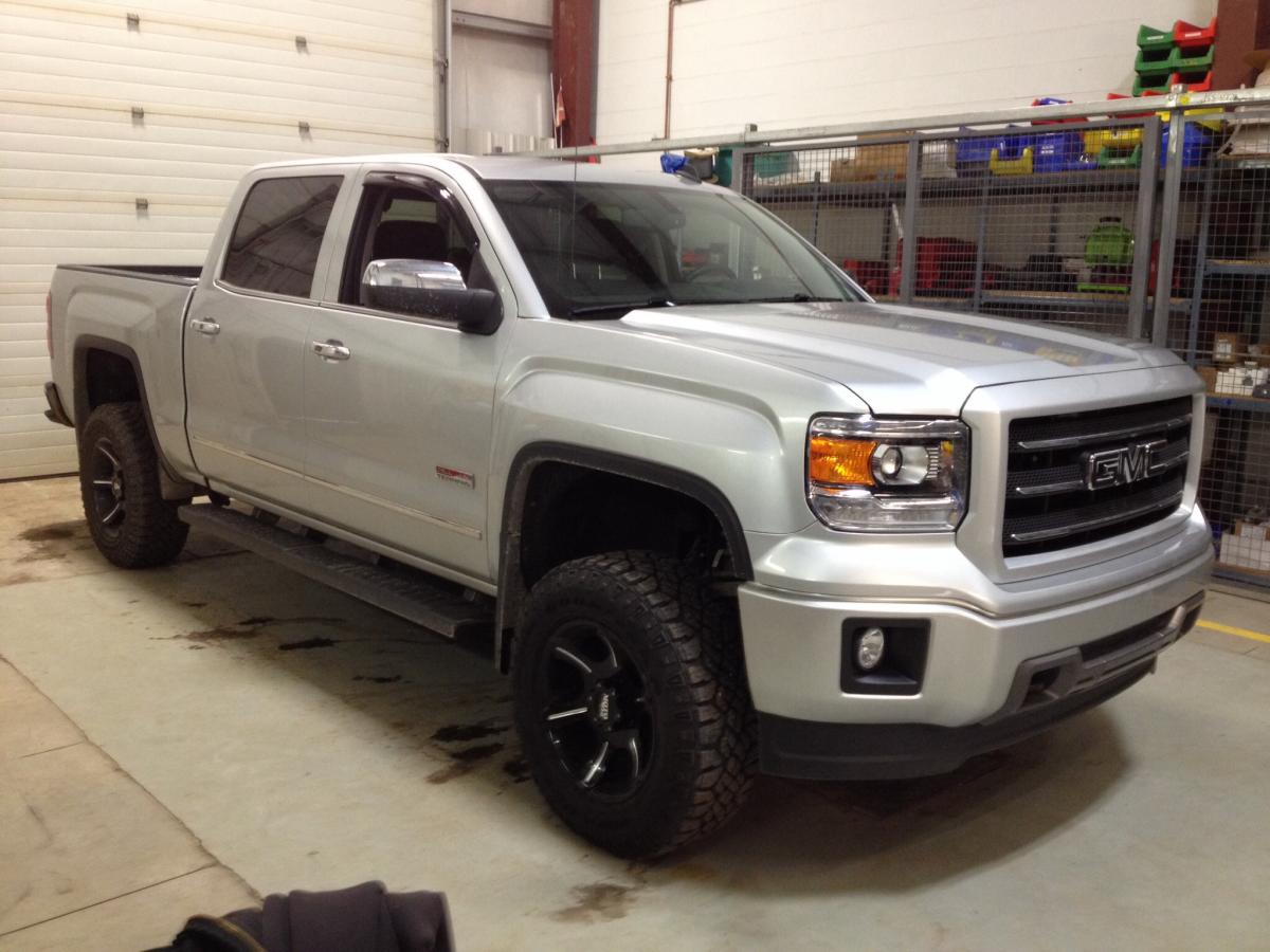

I have a four inch BDS lift on my cc all terrain. What would you like to know?post-125934-0-44948700-1399117037_thumb.jpg

I think this lift or the 5" fabtech is ideal. Suits the truck very well and not "over-the-top".
Nice truck btw
I have a four inch BDS lift on my cc all terrain. What would you like to know?attachicon.gifimage.jpg
that's just the height I'm looking for! Looks awesome. I also have a AT CC are those stock size tires? And how's the ride any difference with cornering? And not to play 20 questions would you mind posting the part number of the kit? Thanks in advance.

Can you run the stock rims?
You can not run stock rims. BDS suggests 4.5 inches of backspacing with 18 inch rims which is 0 offset factory rims are +30 offset I believe. They suggest something different for 20's I believe.
The lift kit also pushes the front tires out an additional 1.5 inches so they do stick out quite a bit. I am still debating fender flares. I don't want them but mud in the door handles gets annoying. For now I have a rag in each door to wipe my hands ha ha.
The tires are 275 65 r18 not sure what stock was but they are slightly bigger than stock I believe. They are basically 32 x 10.8 and there is a ton of room anywhere. I would think 33 x 12.5 shouldnt be a problem.
As for the ride, I have never driven a stock 2014. I drove the dealership's owner's truck which had a fabtech lift and then I drove mine only after it was done. So I don't know how it compares. I do know it rides as good or better than my 2010 with a readylift level kit. I don't know if it is the new design or the lift kit but I have noticed that it doesn't really lean in corners. It stays almost flat.
I don't have a part number. The dealership ordered it. But it was the basic 4 inch lift kit for a crew cab with aluminum control arms. The only choices are steel or aluminum arms and if you want the upgraded struts and shocks.
Hope this all helps. Here is another angle
I should also note that I phoned BDS a few times to ask questions when making my decision and they were awesome to deal with and their warranty is the best in the industry. It is one sentence: you break it, we replace it.

I bought this kit because it lowers everything properly. I looked into Fabtech but it is a glorified level kit and may be ok but with the amount of miles I put on in a year I don't want to be replacing worn out parts due to increased angles. No one could tell me on these new trucks how that kit would work out as everything is new. But I was told a proper lift kit like BDS would be better for me.
