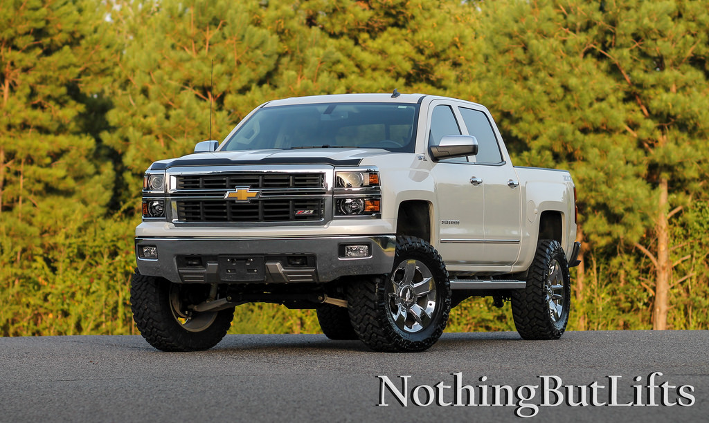

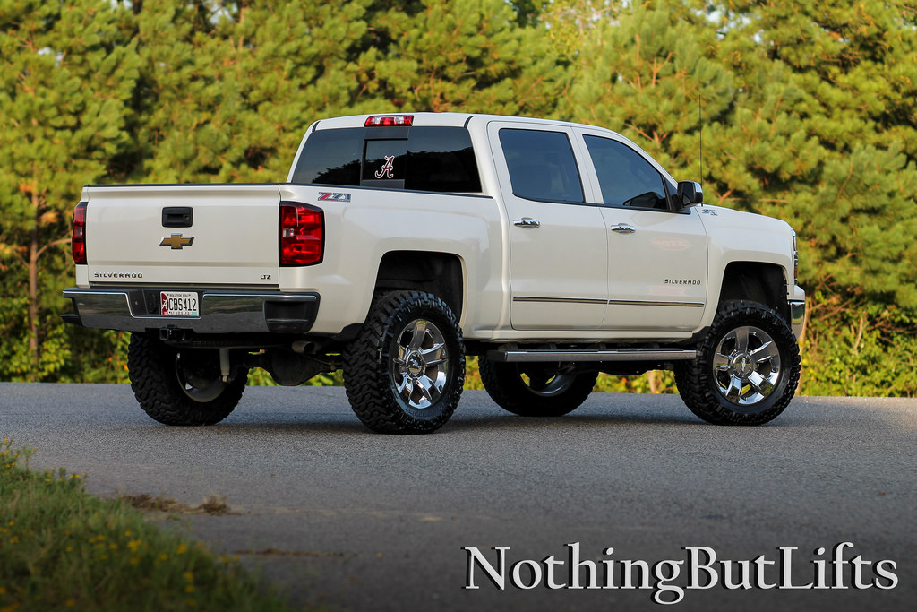

7" Fabtech, Stock 20's and 35" Lexani Mud Beast. Decided to keep the wheels stock for now to see what it looked like. So far im happy with it.
did this setup require spacers at all? looks good.
No spacers at all. If I didn't have the 20's it would need spacers. 18's wouldnt work at all without them
