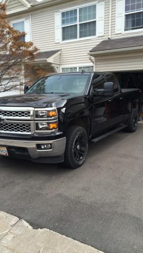

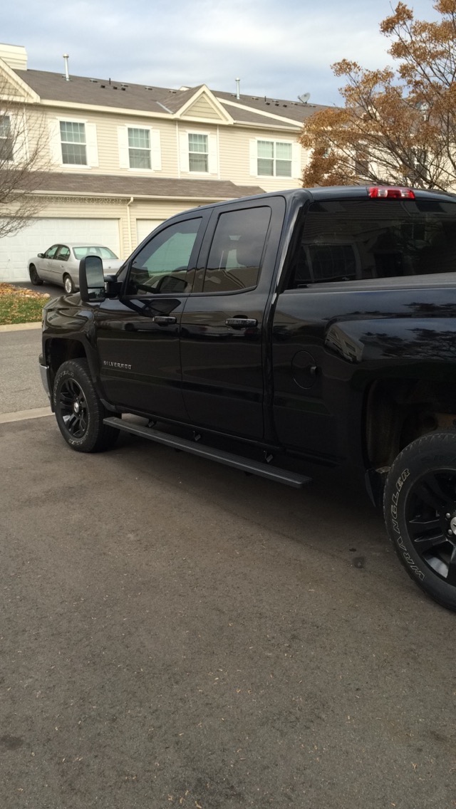

Hey guys, question about wheel and tire fit. I've got a '14 Silverado double cab w/ max trailering pckg, 4x4. I have the RC 2" Level installed, and am wanting to order rims and tires. My main concern is wheel offset. From what I've read throughout the thread, I should be able to run 275/65/20 with minor rubbing, how big of a concern is wheel offset? I'm looking at a variety of different rims ranging from -0- to 35 offset.
Any input would be greatly appreciated.
Will post better quality pictures later next week once I get my wheel/tire dilemma solved.
Thanks again.

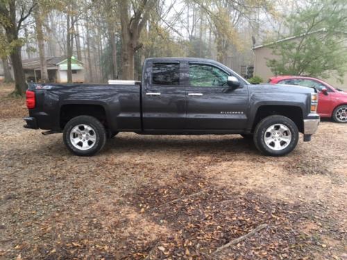

Just installed a 2" Motofab level. Loving it so far, gets an alignment tomorrow morning.
