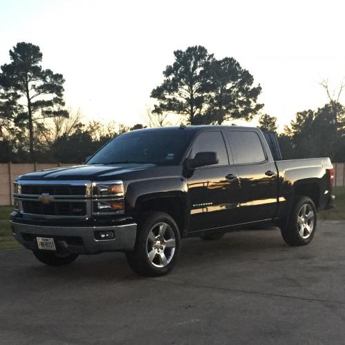

I'm running 33s hate the tire but love the look of her right now. 5c202cd2944a60eef29cab0c7333f000.jpg has a lean due too the parking lot lol
