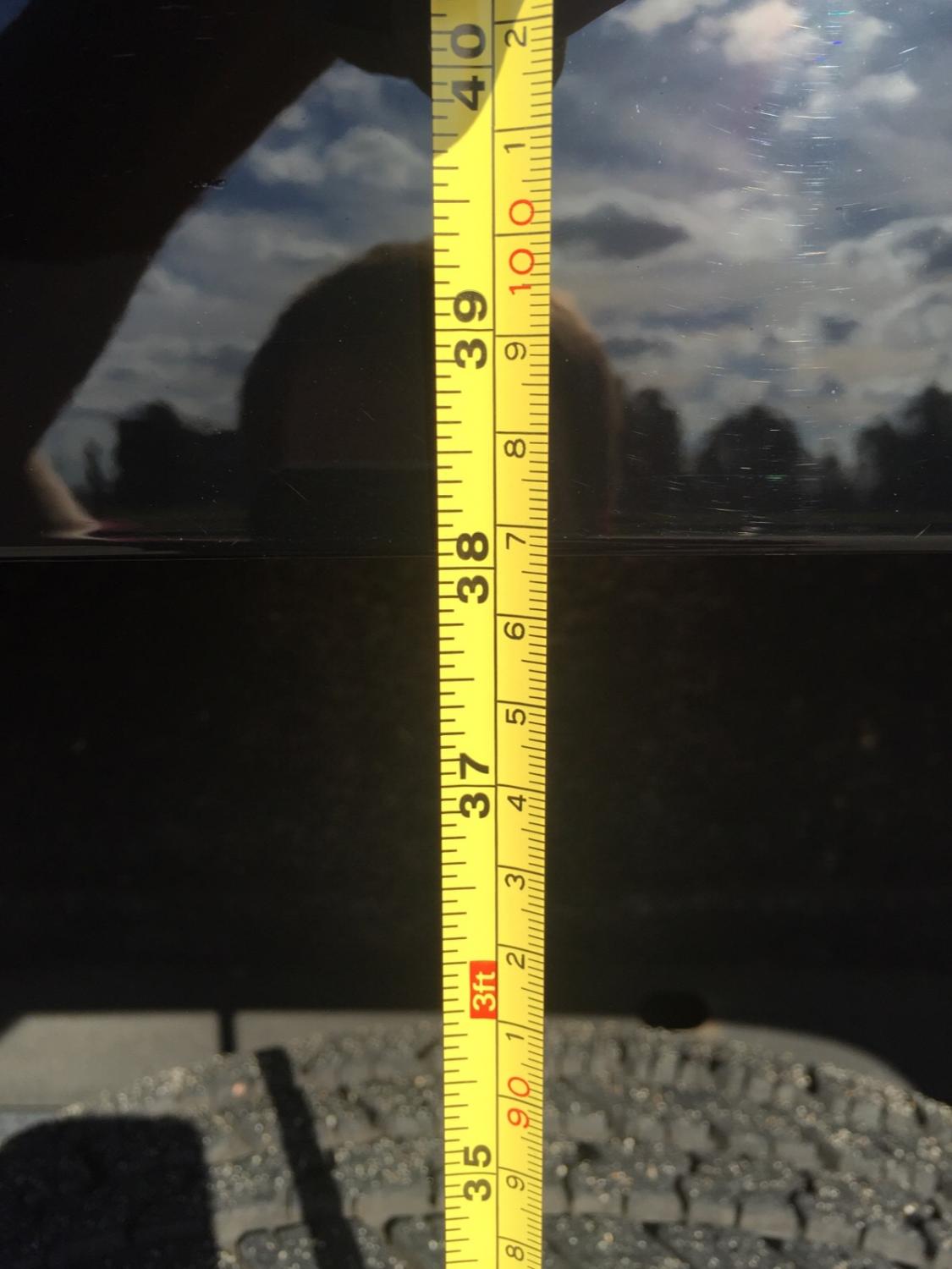

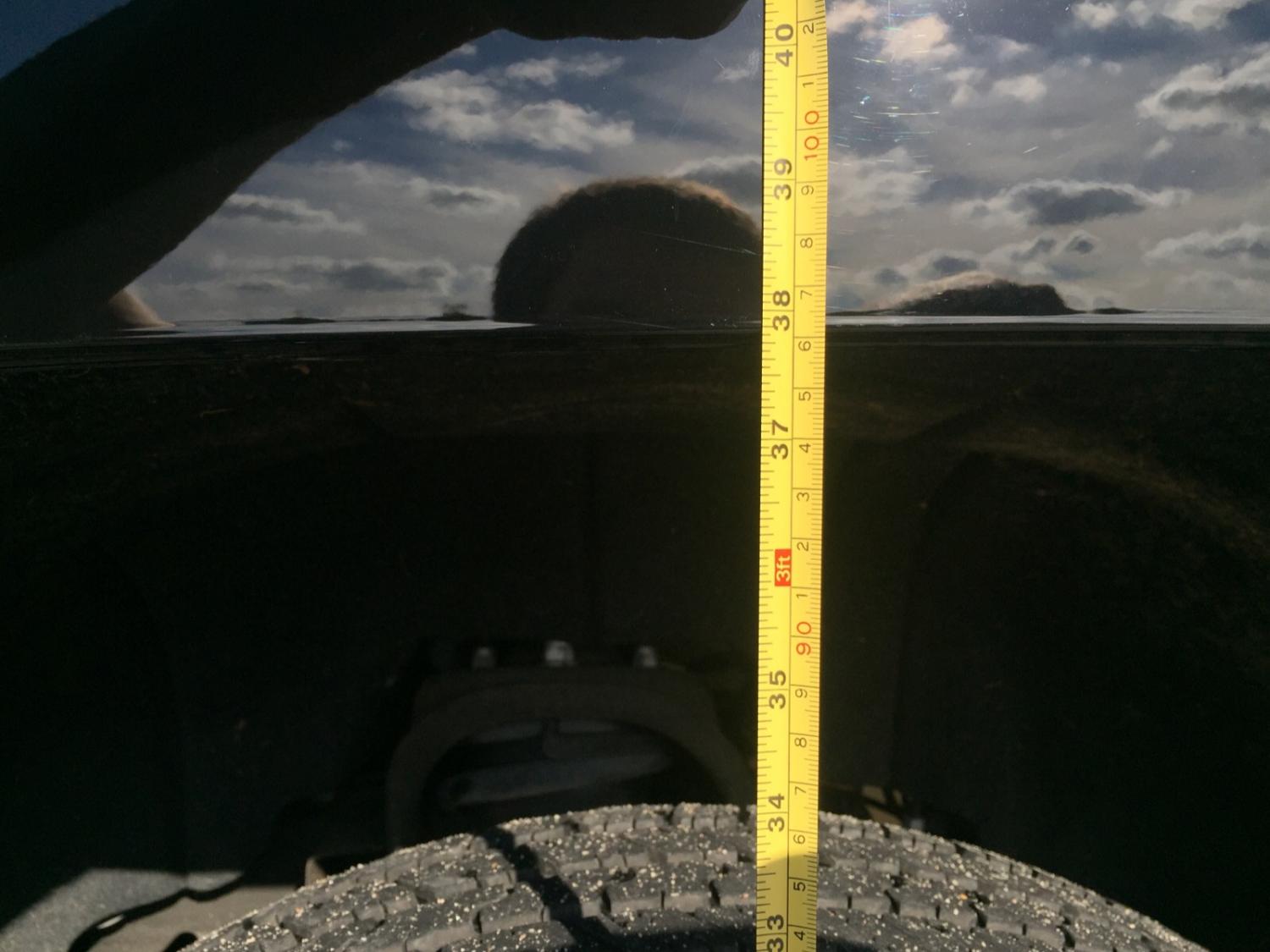

Installed Bilsteins on all four, top setting.
Got an alignment, and also adjusted my headlights.
Took notes of before and after for fender wall heights.
Stock Rancho Shocks:
* Front Left -- 35.75"
* Front Right -- 35.75"
* Rear Left -- 39.25"
* Rear Right -- 38.75"
Bilstein Shocks:
* Front Left -- 37.75"
* Front Right -- 37.75"
* Rear Right -- 39.125"
1.5" of rake, but that's exactly what I wanted.
Waaaaay smoother than the stock Ranchos.
Night and day difference, great investment.

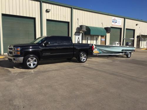

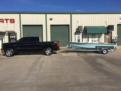

Got some pics with the boat attached. 37.75" in front, 38.0625" in back. That's still 5/16" of rake. Granted, if I loaded the bed down more, or put a heavier trailer on, I'd probably end up slightly nose high. I kind of anticipated that being a possibility, in which case I want to look into getting the Roadmaster Active Suspension. It's like add a leaf, but helps handling whether you have a trailer/loaded bed or not, plus you don't have to take anything apart... Worth the research.
