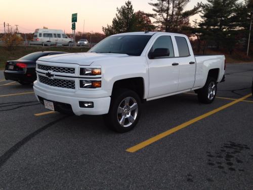

2 inch RC level with 275/65/20 GY duratracs. Haven't noticed any rub, looks close to the carpet liner only.
I know this post is a month old already but I just came across it and I was actually thinking of doing this set up with my truck. How high does your truck sit now? Also, how off is your speedometer?
I never measured the height of the truck but can do so later. The speedometer is off according to a tire size comparison website but never actually checked against gps. The calculator says at 40mph the truck is really going 42.8 mph. The faster you go the greater it is off.. At 70 the truck is really going 74.
I like the duratracs and am considering. Has your mileage been affected much by the level and tire swap? You're the first I've seen with the exact setup and size I want.
I like the duratracs and am considering. Has your mileage been affected much by the level and tire swap? You're the first I've seen with the exact setup and size I want.[/quote
Not gonna lie , I haven't calculated the gas mileage. You can't go off the DIC anymore cause I've traveled further than it is calculating. I don't drive too far for work so even if it did suffer It wouldn't bother me much.
